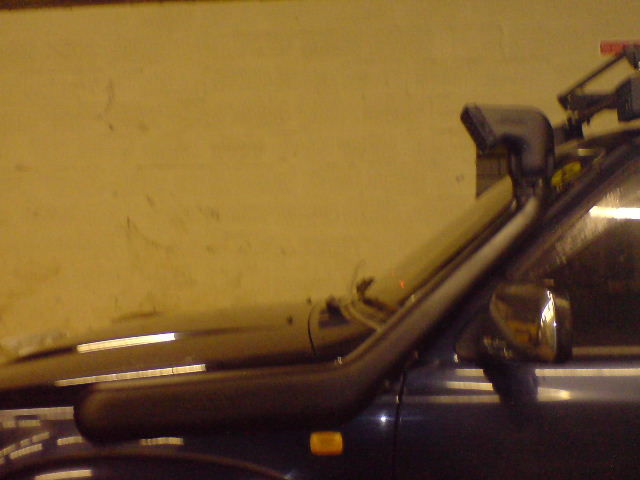

Thats brilliant carl i was looking under the bonnet trying to work out how i could make one, id love it if you could tell me dimmensions ???
after the last wading episode i think ill be better off with a snorkel and some diff breathers !!
In fact can i borrow your truck to copy your veg conversion , snorkel , lift , intercooler !!!
Dimensions i dont know, cos i just held bits up until i found the right one, Then diff breathers are a doddle, Intercooler is easy with body lift. Trial and error for me, i'd have to do the same to yours mate, just marry stuff up til it looks right.
hahaha, yeh, although im actually english..... just tight, and i think it looks all of the £2.50 worth. Average joe on the street know niffink about snorkels tjm or anything so they think its a proper job.
Good enough for me. As long as she can breath underwater

do you have a pic of the snorkrl going thru the wing??
Not yet ill get one tommos for ya, but just line it up so hole goes straight through the wing and direct to the filter box inlet. Youll have to remove a sensor mounted on the inner wing and remount it
