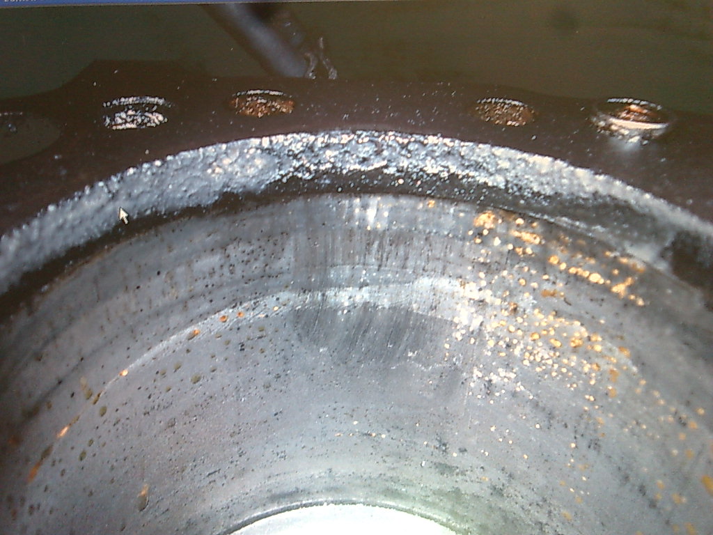

                          just removed cylinder head on surf found top of liners on no4 in very poor condition running 10mm down from top edge (see picture), not sure if this is a common problem on this engine would appreciate peoples views and what i should do next
                            @ supersurf might be interested in that 2.4 bottom end as the big ends went on my otherwise ok 2.4 last week email me on sday@orange.net with a price.
