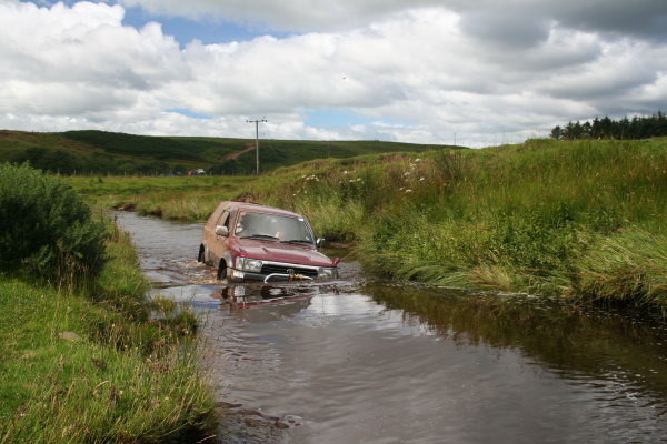

On a standard ride height Gen 2, what depth water can I safely drive through before needing a snorkel? I drove through a ford today that read 2 feet deep and SWMBO thought we were gonna be swept out to sea or summat. Shall I get one anyway cos they look cool?
Snorkel
I measured the air inlet height at something like 31" once, on a 5" lifted Surf. Soooo, I guess you were bl00dy close!
Snorkel isn't really there so you can wade to the top of your windscreen. Treat it as an insurance policy.
Oh, and they do look cool.
I went over bonnet depth before the snorkel, but i did have the elbow on the dirty side of the airbox disconnected from the intake and turned 90 degrees. But i wouldn't recommend going that deep, the standard air intake is behind the passenger headlight. So anywhere close to or over that is risky to say the least.Originally posted by Jonny77On a standard ride height Gen 2, what depth water can I safely drive through before needing a snorkel?

I guess I will be getting one then
thanks for the pics, I'm sold!
