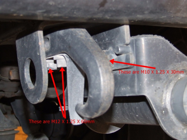

    Also tried to fit my A Bar and cant seem to find how it locates up front. It looks like it should be fairly simple as the is locating pins there but it doesnt seem to sit anywhere near the chasis.

    Also tried to fit my A Bar and cant seem to find how it locates up front. It looks like it should be fairly simple as the is locating pins there but it doesnt seem to sit anywhere near the chasis.Missing the brackets??

        wont the a-bar fit onto where you got the 2 hooks on the front?

              I have the same bar, i've just fitted.
              Will post up a pic of brackets later when the wife gets home from shopping!(they are missing from your second pic)
              They attatch to the underside of the font chassis rails, where the towing hooks are normally located.

                  At the underside next to the recovery points, you should see either two brackets or four holes in the chassis rails - this is where you attach your A bar

                    These are the brackets I have.
                    Nev
                        Nev
                        Thats the ones.......cheers nev saves me putting up a pic
                        www.daemon4x4.org
                          Cheers guys yup I can see how those would make it easier to fit. My mates idea of duck tape probably wouldnt support the weight of the spot lights. I have emailed the guy i got the bar from to see if he still has them.

                              heres the brackets.
                              before
                              and after
