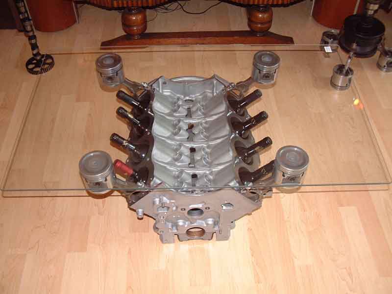

    Plating it not really a sensible option, unless you making a wine rack or coffee table out of it.
    Sand blasting is you best bet, other than that, good oven cleaners are great for getting oily grime from engine parts, but go careful if its alloy, it'll melt!!!

                      Easiest cheapest way to clean a block is to take it to an engine builder and have them throw it in their chemical tank for a while... Rover V8's make rather nice coffee tables

                        P.s I like the coffee table anyone have one of these?
