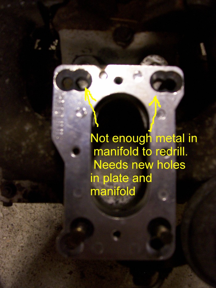

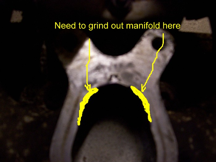

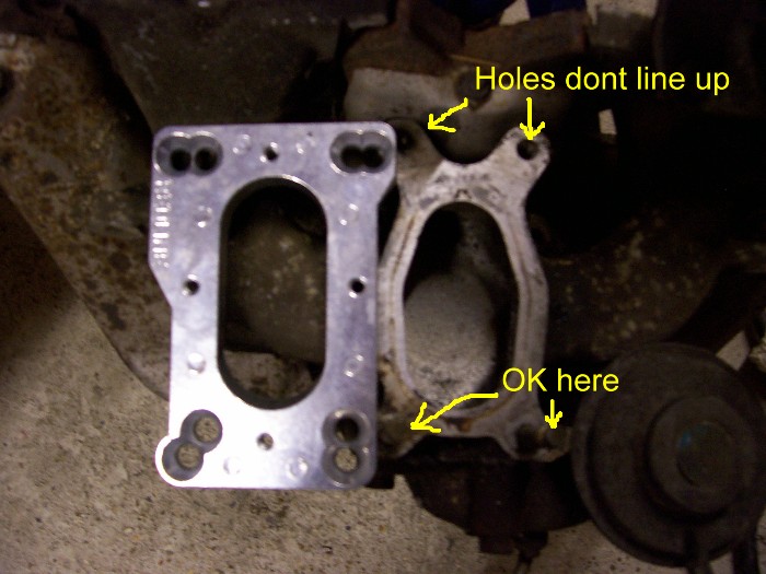

Mark pics of the Weber adaptor plate and the fitting prob.
@Surfenstein
bugga,i can see that now,rick can you do me a favour and turn the plate round 180 degrees on the manifold so that the bottom two holes now go to the top and take a pic.or are they even further out.Originally posted by Vagrant No2Mark pics of the Weber adaptor plate and the fitting prob.Last edited by surfenstein; 6 December 2007, 19:23.www.overfab.uk
