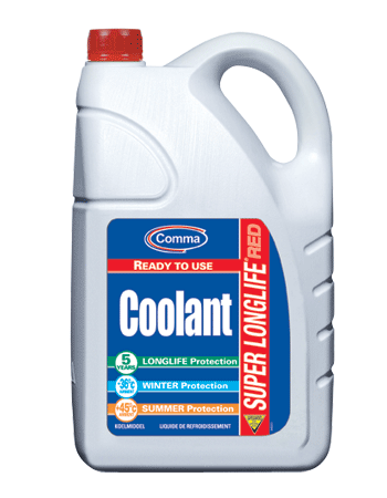

                      Do you guys all run antifreeze and water then instead of toyota 4life??

                        I just use the normal Car Plan or Bluecol antifreeze which contains ethylene glycol (blue in colour).
                        I've heard of the 4life which I think is red in colour and has a built in Acidity detector - turns yellow when it detects combustion gases in the cooling system. I suspect it will be a 'dealer only' part and quite expensive?

                          I use this
                          Trust your Hound.
                            halfords advaned something or other posh name coolant is red, that's what i use. I'll go see what it is actually called in a minute.
