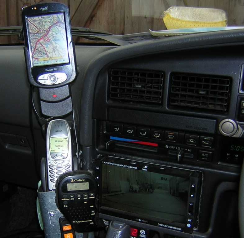

Yep thats it. I am now thinking of altering the TOMTOM mounting bracket so that i can screw it to the dash, I might have to get an older bracket with the rigid plastic base.Originally posted by MaverickYou mean something like this?
It's attached using the mounting holes for the handsfree kit.
SWIFT AND BOLD
Is that a tv i spy there or reversing camera thingy?Originally posted by MaverickYou mean something like this?
As for removeing the vents, i did it a while back for gauges not sat nav, you'll find a big plastic squarish elbow, i cut the lower half off, tapped it up and stuck it back on to stop hot air comeing out there and being a problem, you gain a lot of room in there, i fitted spare fuse blocks for live and ign feeds plus
panel lights and an earth block, mind i did away with the useless cup holders too, see if i can find any pics of the inside etc
