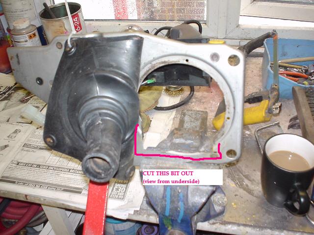

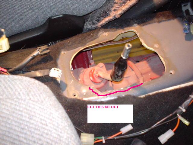

                        All the above and unclip the rubber splash things that clip to the inner wing and chassi, not important but i $hit meself when they went "ping" also had to cut out for the transfer lever as in pics, and have WD40 handy
                          Pink transfer case???
                            It's just the way the colour came out in the pic! honestly
