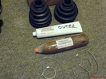

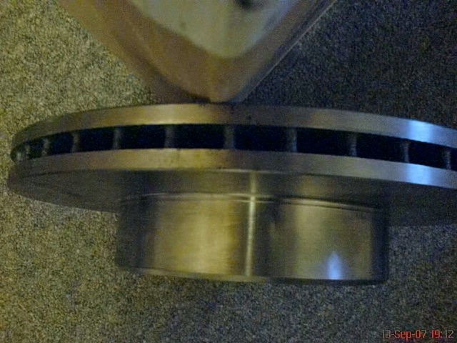

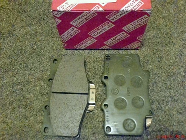

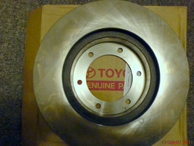

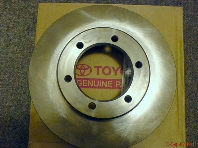

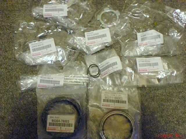

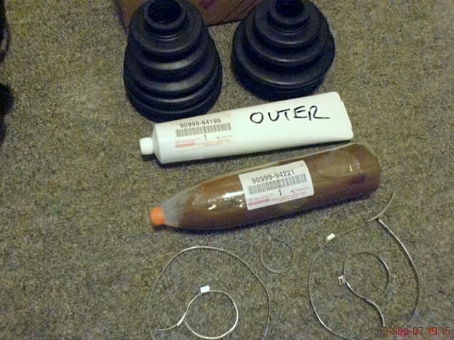

Well, I've got all the bits I need to replace my rubber boots. I've also got 2 brand new vented OE brake discs with all new oil seals, dust seals, pads, retaining pins, anti rattle plates etc,etc, all from Toyota. I was going to start the job today, but I've looked everywhere for the correct size socket for my hub nuts.
