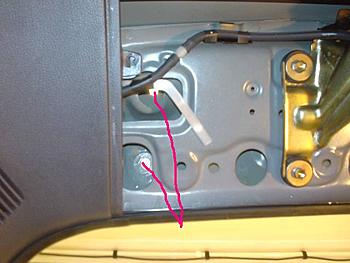

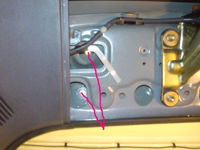

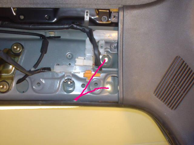

These are the holes you need to drill for fixeing it, plus the one for the harness grommet, theres a cut out in the double skinning already there, drill a pilot hole from inside and dont froget to mask over the outside to stop the drill running off, break light just plugs in there, connector already in place,
