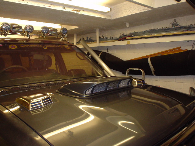

hi chaps am readey to order a scoop for the surf, am thinking of gettin the subaru impreza STI replica, will it look right, am not sure, what do u lot think, its the one that leans forward at the front, but am facing it towads the screen, the ebay number is 17039502092 dont no how to post a link, so what do u think. mick

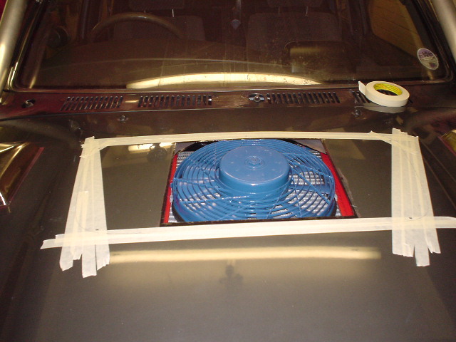

nice one ian, when u fitted it did u replace the struts u had to cut out or was it ok, i need to cut a 10 inch hole to fit a kenlowe fan, what am thinkin is just fit the scoop without the fan an see how it is , then if needed get the fan, what u think, an cheers trev missed out a 1 in the number.

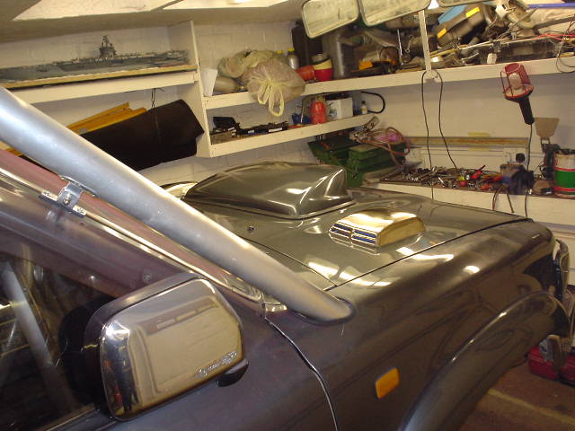

You mean the struts on the bonnet? no, thought it was going to be really flimsey but it aint too bad especially since i already cut two holes for the extractor vents and lost a bit of braceing there as well, droops a little opposite side to the stay bar but not bad, cant remember off hand the size of the hole i cut but it wer'nt far off 10 inches, a 9" kenlow type fan just fits under it, have you fitted an intercooler or is this to let hot air out?, either way i suppose a fan would be better than none,Originally posted by joymicnice one ian, when u fitted it did u replace the struts u had to cut out or was it ok, i need to cut a 10 inch hole to fit a kenlowe fan, what am thinkin is just fit the scoop without the fan an see how it is , then if needed get the fan, what u think, an cheers trev missed out a 1 in the number.Too young to die and too old to give a toss

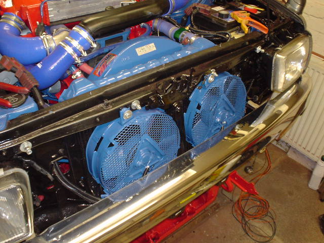

No, an intercooler just cools the air comeing from the turbo to the inlet, cooler (dense'er)air going in= more power, well thats the idea anyway, if you just want to help cool the engine down a bit there's several things you can do, one of which is what your planning, hole in the hood vent and possibly a fan, also fit a switch in the back up fan (the one on the front) so you can flick it on manually, dead easy to do, just cut the wire that goes to the sensor on the water filler neck, and join two wires to each end and feed em to a toggle switch in the cab, i've rewired the whole thing thanks mainly to mattf, fitted two fans on the front and wired em so i have the option of on (auto) running on the engine sensor, off alltogether, and on manually, also rewireing useing a batt feed the fans will run on after the ign is turned off,
(like normal cars) got a wireing diag if ya need itToo young to die and too old to give a toss

am a dipstick!! read all the treads on it an never sussed that, the scoop u have? is what am goin for i think, looks cool on your truck, i suppose its a bit like surfiensteins as in size an that looks realy good, right ebay here i come, thanks ian for all u input. mick ps .. that truck of yours is goin to look the nuts when its finished.
