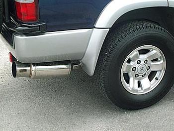

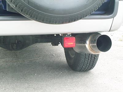

I know it was not cheap but I have spent 2 months trying to get a tow-bar to fit and find someone willing enough to make the adjustments needed and still guarantee the safety. So I am just glad that finally got it sorted.Originally posted by laser_jock99You've paid a lot mate....the Anker Towbar kit comes with brackets to move the exhaust across and the spare tyre wind down gear (if necessary). Fitted the bar myself and had the electrics done locally for £20.
Fair play- you've got a mega exhaust hanging off the back there. One question- why is it the oppposite side to mine?Originally posted by Flip-FlopI know it was not cheap but I have spent 2 months trying to get a tow-bar to fit and find someone willing enough to make the adjustments needed and still guarantee the safety. So I am just glad that finally got it sorted.Last edited by laser_jock99; 11 September 2003, 23:05.
thats not the exhaust, its a rocket launcherOriginally posted by laser_jock99Fair play- you've got a mega exhaust hanging off the back there. One question- why is it the oppposite side to mine?[font=Times New Roman][size=3]
[size=5][/size]
All 3rd gen exhausts (well diesel anyway) exit on the drivers side.Maurice
