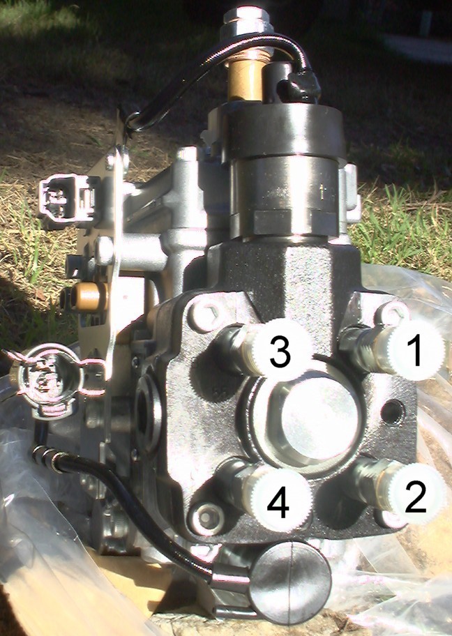

    RE: the rough idleing, are the injector pipes re-fitted in the correct order?
      Yeah, the injectors are on right, made sure of that. The rough idling started a couple of weeks ago, before the head swap.
