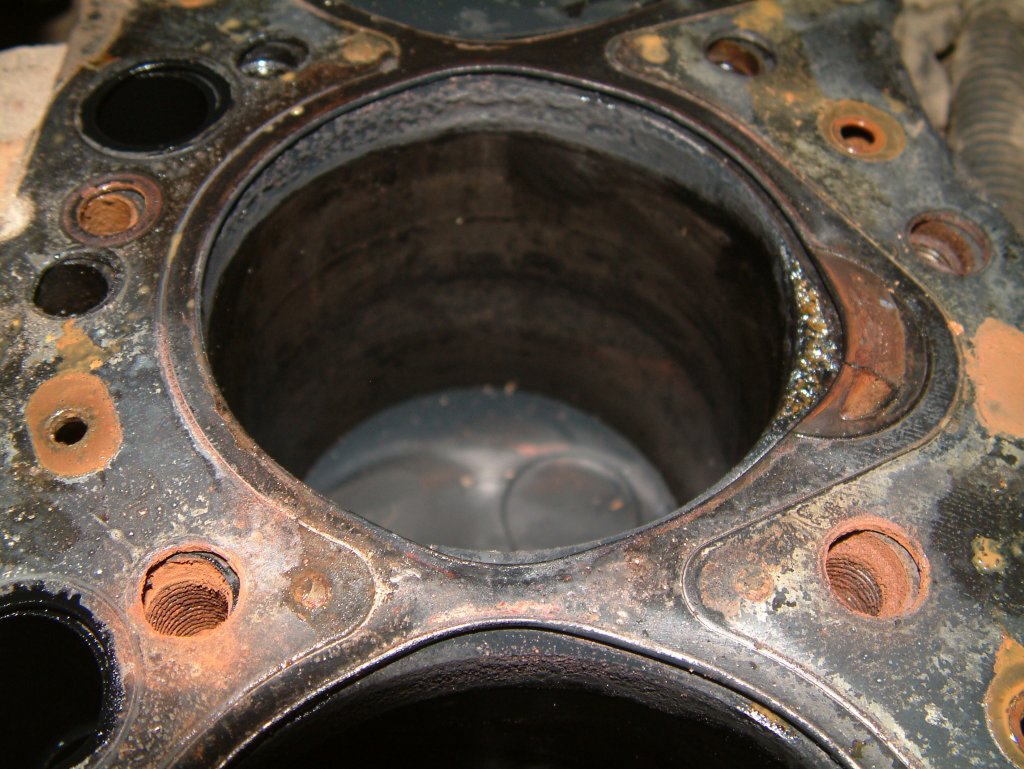

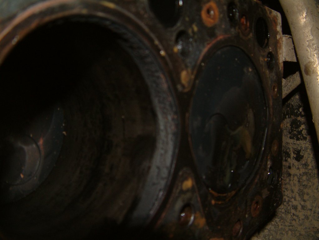

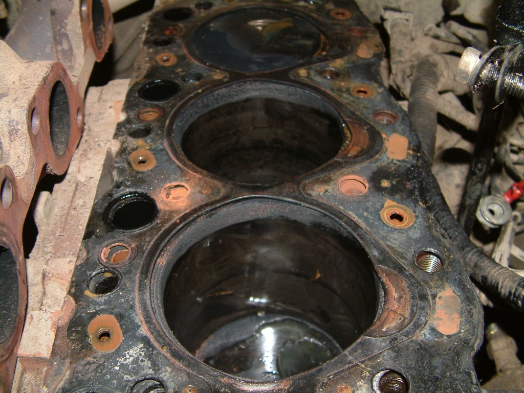

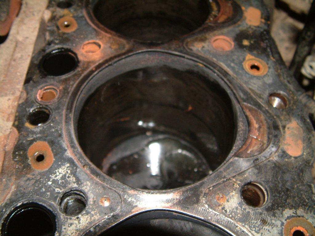

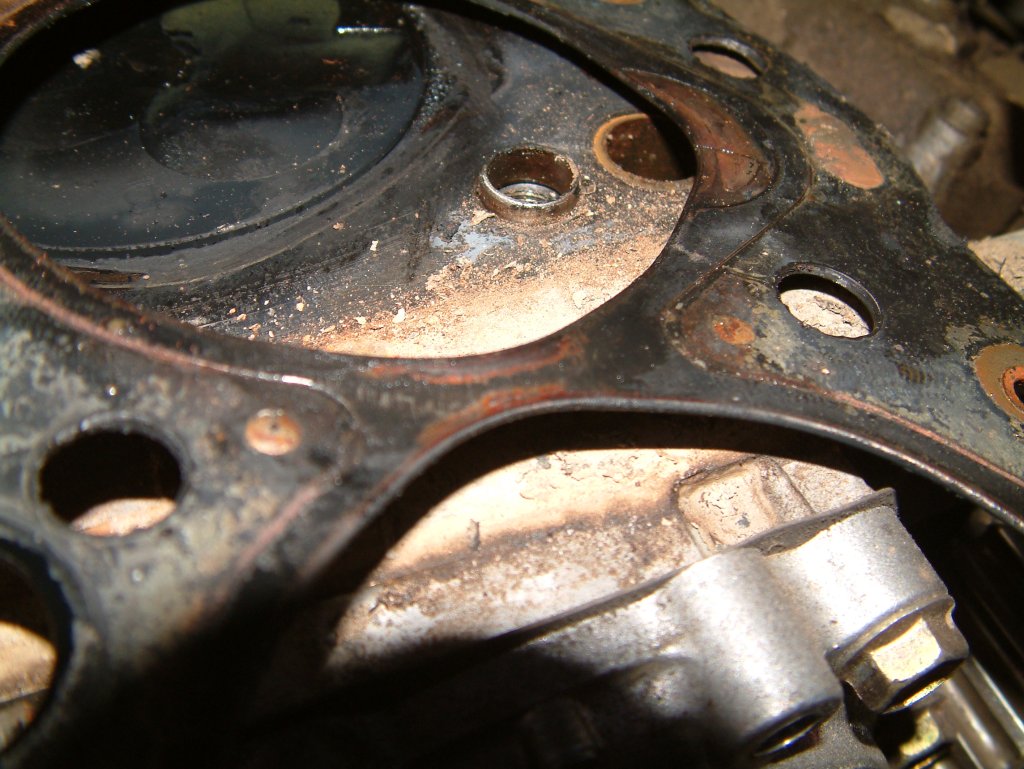

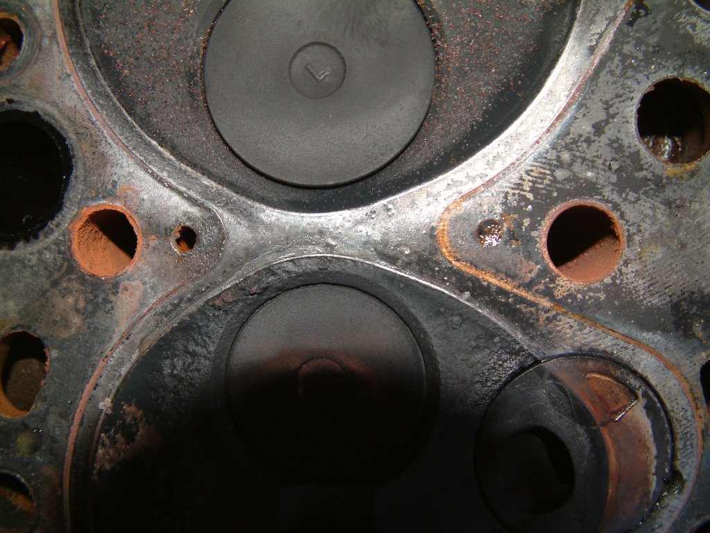

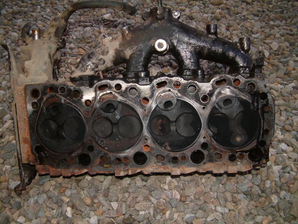

OK, old head is off now, and I've looked it over. First thing, there are no obvious signs of cracks between the valves. Overall, it looks to be in OK condition.
However:
The bolt holes between 2 and 3 are showing obvious signs of rust, and the bolts that came out from there have quite a bit of surface corrosion.
#3 cylinder has a quite deep sort of pit at the top of the bore, above the stroke of the piston
The gasket is slightly disformed between cylinders 1 and 2, although we're not certain that this wasn't caused whilst pulling the head off.
I've attached some pics, although they're not in the best of focus.
Thoughts?

So yes, it's had a drinking problem for a little while.
