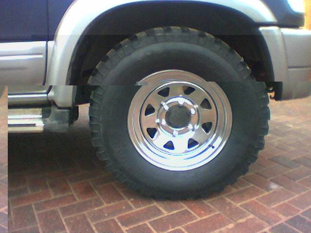

                    esp. if you wanna put some big shiny new ones on!
