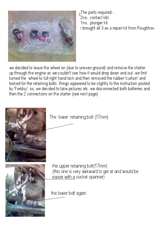

            Dave, parts I bought for my 2nd Gen 3 liter were;
            T28226-54220.....Starter Kit...........£9.39
            T28226-54320.....Starter Kit...........£5.78
            T28235-17030.....Plunger, Switch....£14.92

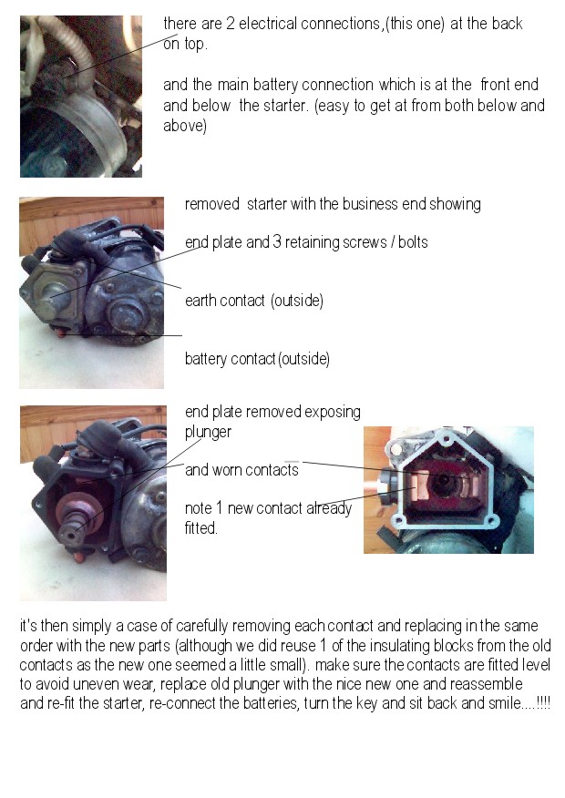

              here ya go mate,
              here's some pictures we took when we did mine. this also shows the bolts that you need to undo to get the bugger off. good luck, hope it helps
