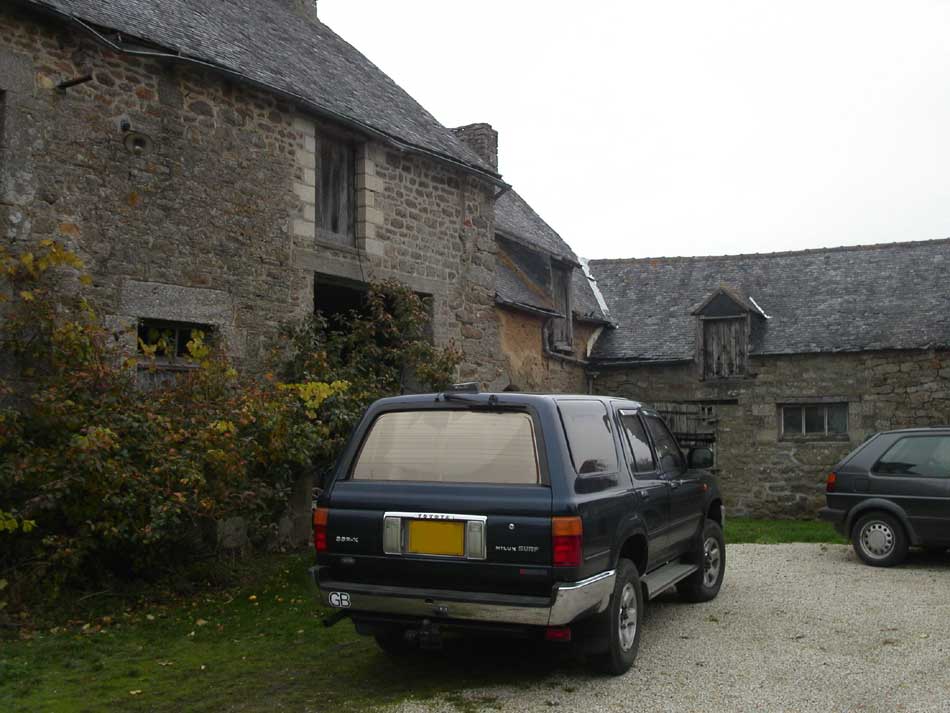

                              • #30
                                The missus an' me are in the process of buying this property in Brittany, so after you lot have helped pauleds you can come over and help us There'sjust over an acre of land with it so how many surfs and caravans can we get on there???
