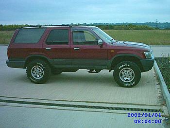

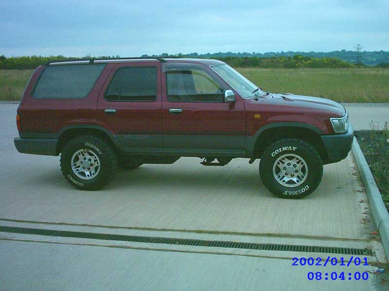

          Here's a bit of a photo diary...........
            Has the "after" shot been raised or is it just the new springs? Looks great

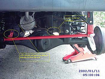

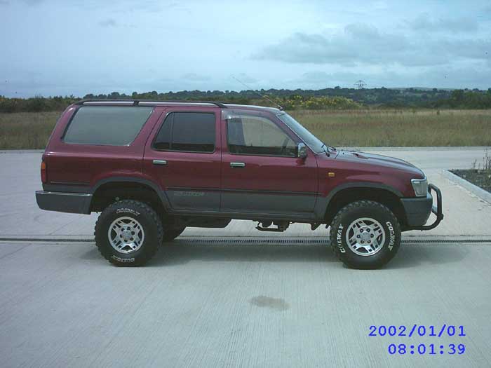

              Heres mine after a 2"lift front and rear.
              i used the uprated standard height springs + 2" spacers from 4crawler USA, and jacked up the front torsion bars.
              I modified my existing panard rod with 24mm stainless threaded bar to make an infinitely adjustable rod without having to fit drop brackets.
              I measured the pitch of the bracket mounts then cut bar in half. i threaded each end of the rod internally for 8" with a 24mm tap. I then joined the two halfs with 24mm stud and locknuts. took a bit of effort but I have now accuratley realigned my rear axle centrally under rear of car.

                Raised about three inches, with Landcruiser springs and Procomp ES3000 shocks.

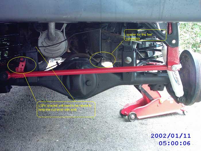

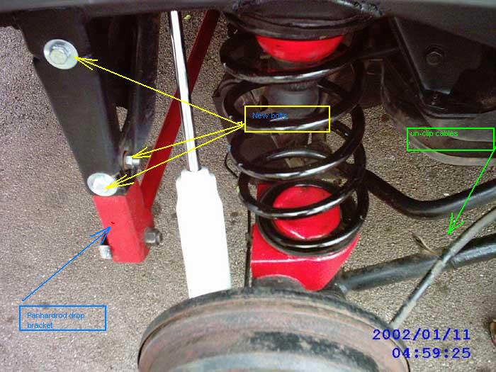

                        Luckily my rod LOL was an adjustable one so hasnt proved a problem....i still put a drop bracket in though.....The Landcruiser spec height coils lift the rear exactly 3" in height compared to the Milner coils....i know......

                          Yes the rod is hollow and ready to take 24mm tap. I tapped mine a good 8" deep each end, and inserted about 7" of stud into each.
                          I cut my panard rod about 10" in from drivers side end so adjuster didn't foul diff casing, and also cut out and discarded about 2" of the rod to make space for two M24 nuts.
                          in the picture the left lock nut has been welded to the original rod and then the stud welded to the nut. this makes one end solid. to adjust length I slacken right hand side lock nut, unscrew end of rod to achieve desired length then tighten lock nut in place.
