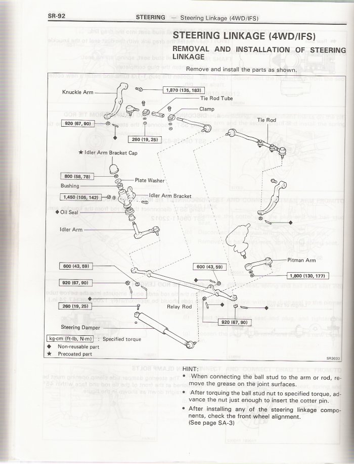

However steering on the way home is a bit dodgy very woolly and pulling badly to right, it wasn't that great to start with. replaced the steering idler a while ago with no real difference had wheel alignment set then too.
Anybody any suggestions?? was told that if the balljoints are knackered it can cause wonky steering
