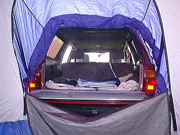

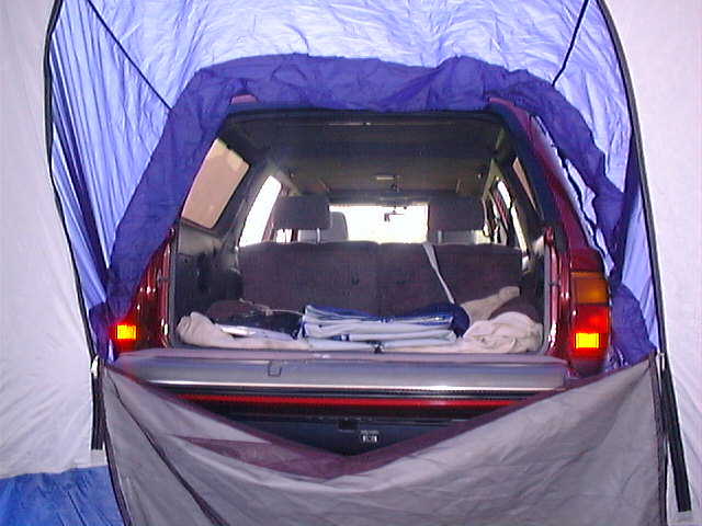

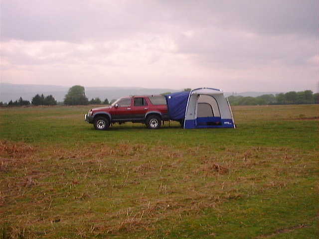

                        Do you really need a roof tent? how about one of these.....
                          thats neat where you get it and how much ??
                          Enjoying Life after Cancer
                          Pops
                            I got mine from here a couple of years ago.
                            http://trucktoys4less.com/sporsuvminte.html
                              thats a nice tent ya got there, but i think its probably pretty hard to pitch it in a very small awkward space, very uneven ground, or on a sand dune/ soft beach or on some rocks....
