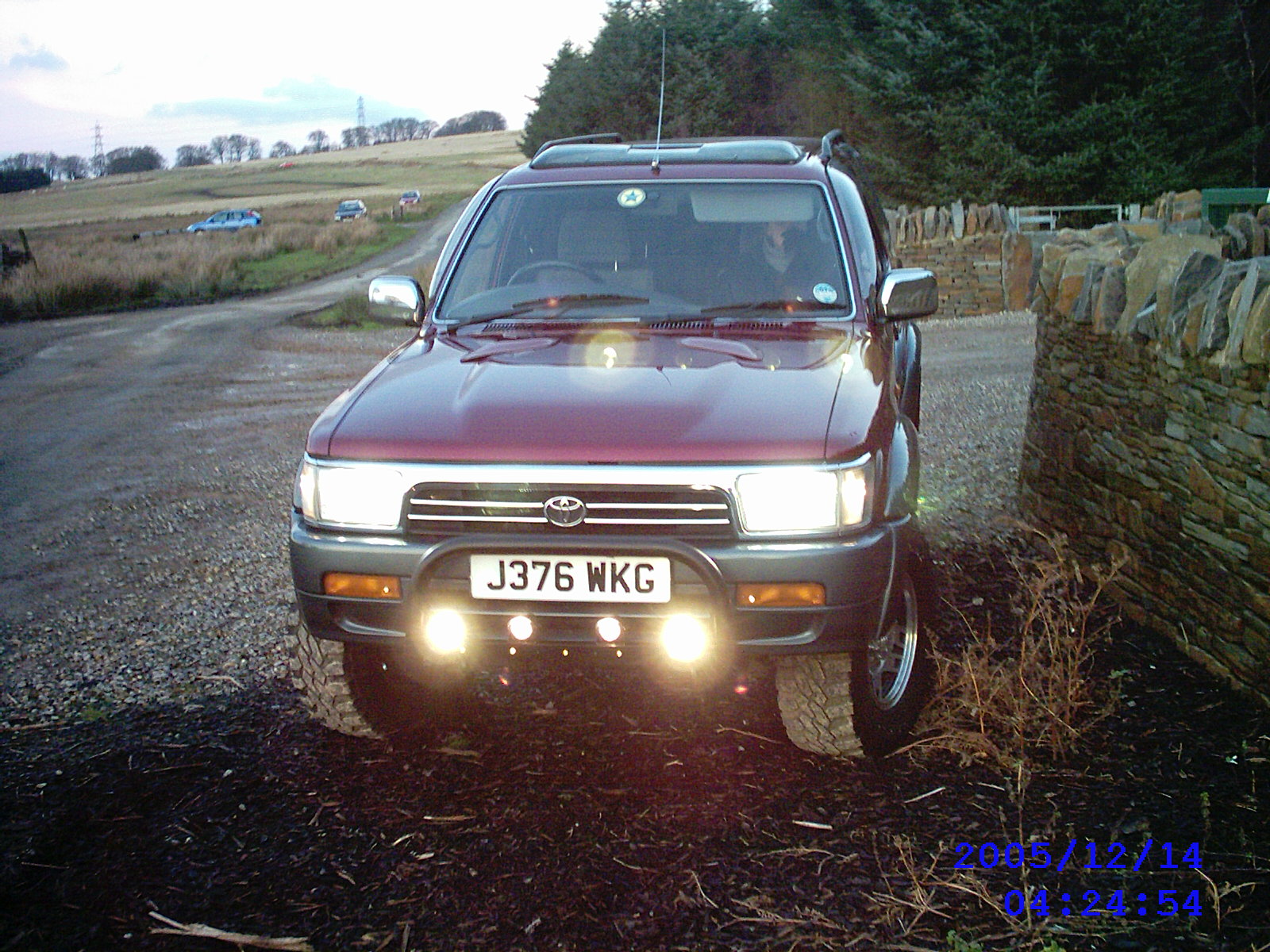

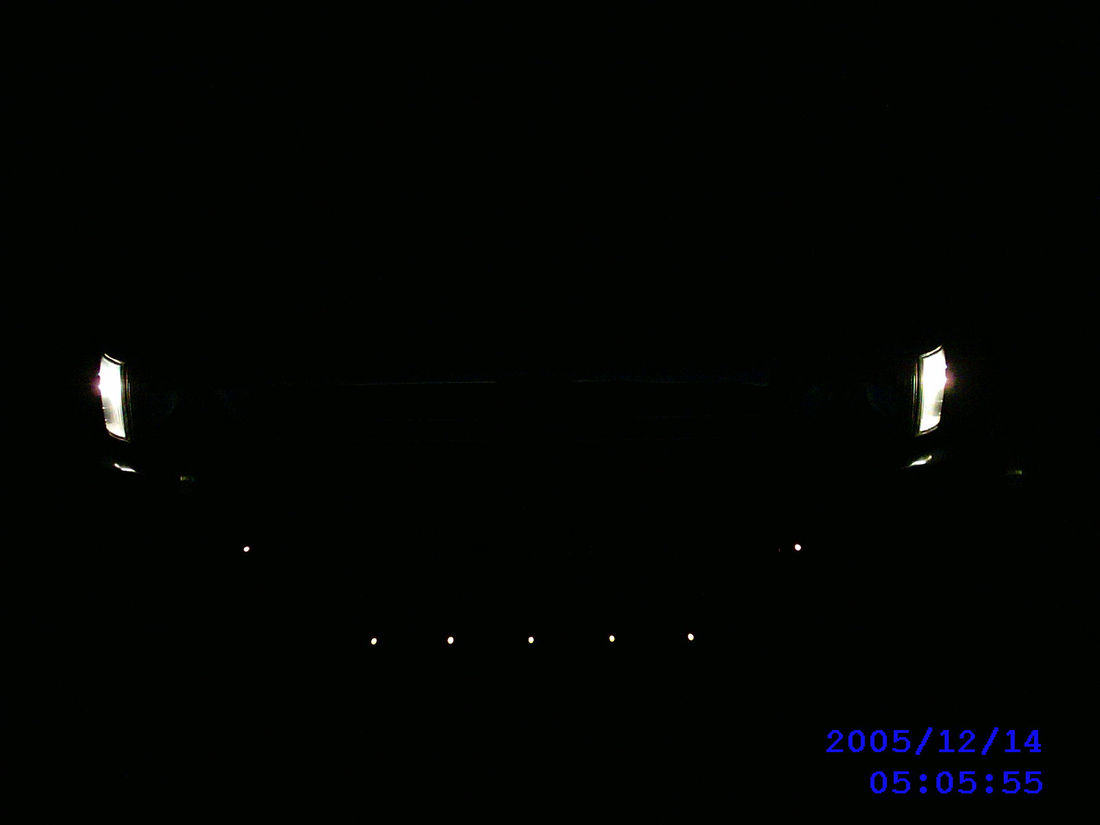

                  Ahem........not a very good pic, but they are amber LEDs fitted into a new A-bar cross brace.
                      they look excellent at night!
                      give off as much light as a much bigger lamp.

                        Looks good, Thinking of something like that along the front of roof, Marker
                        lights, amber or blue? Dont know if there leagal but seen em on hgvs, I can
                        see you lighting up the underside, yet hehe,
                          i'll see if i can find the link to police website... but all colours are legal except RED (which can only be used on the rear) and blue CANNOT flash.
                            from the Thames Valley Police website
                            Q:Is it illegal to fit or use blue lights on my vehicle?A:The answer depends on the type of lights concerned. The law on this area is governed by the Road Vehicles Lighting Regulations 1989. It is worth expanding on some of these regulations:
                            • regulation 11(1) states; "No vehicle shall be fitted with a lamp which is capable of showing a red light to the front ...." (with certain exceptions, including side marker lamps and reflectors, some types of warning beacon, and others)
                            • regulation 11(2) deals with rear lights and states; "No vehicle shall be fitted with a lamp which is capable of showing any light to the rear, other than a red light ....." (again with exceptions including indicators, reversing lights, registration plate lights, warning beacons and others)
                            • regulation 16 restricts the fitting of blue lights of specific types; “beacons” which by definition rotate through 360 degrees, and “special lamps” which by definition are capable of emitting a blue flashing light
                            • regulation 27 states that lights should not cause undue dazzle or discomfort.
                            In simple terms this means a red light cannot be shown to the front but any other colour can (with restrictions and exceptions), and only a red light can be shown to the rear (again with certain exceptions). Therefore, showing a fixed light (other than a red light) to the front is generally not an offence under the current regulations unless it is bright enough to cause undue dazzle or discomfort.
                            We have also received queries on blue lights mounted under vehicles, with their light visible indirectly from a reflection on the road. A legal precedent has yet to be established, and we would advise any members of the public who are in doubt to seek their own legal advice on this particular type of light.
                            Members of the public should be aware that any lights that clearly contravene the Road Vehicle Lighting Regulations may be treated accordingly by the police.
