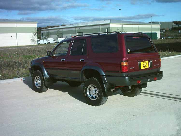

          You mean like this?
            You mean like this?
            Would something like that effect the handling?

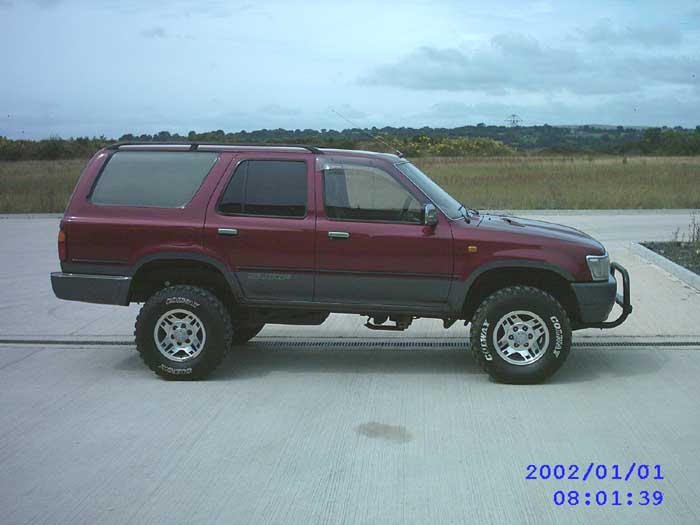

                    Thanks mate. I did have a look around some threads, and that was the method used. I have the standard wheel rims like Vince's. I definitely have ars* sag, as it's lower than the front, and she leans over to the offside.
                      You mean like this?
                      WOW, nice truck vince.
                      Tell me what mods you have done to her? Also what is your suspension set up? I would love mine to look like yours, bit higher at the back. Can you tell me what you did to get her like that?
                      And your rims are the same as mine, but look like thay have been chromed as they are very shiney!!

                        As for the suspension, I've got 1995 Landcruiser HD80 rear springs fitted together with Procomp ES3000 shocks, Panhard rod drop bracket.
                        I've still haven't wound the front torsion bars up yet or replaced the front shocks.
                        This pic was taken after I removed the wheel arch extensions back in the summer. They are back on now 'cos of the wetter weather.

                          Mine has same spec HDJ80 coils but are less rated so give better ride.....Also, when you adjust the front this has an effect on the rear i.e. lift the front the rear will go up a small amount. All to with corner weights and yes it is true and i have witnessed it with my own truck...
                            So, HDJ80 coils are the same, but softer? Great. Have either of you guys, Vince & Dog Book, changed the torsion bars or are they standard?

                              No, My HDJ80 coils are standard Landcruiser and are really firm. DogBooks coils are the same length (to give the same amount of lift) but he had them re-made so that they are softer.
                              I haven't replaced my torsion bars yet, but I will be adjusting them soon.
