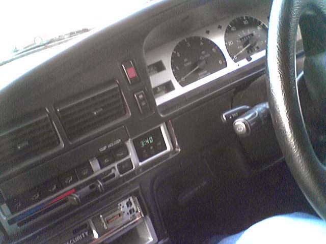

              Here's a pic in daylight though.
                Silver dial surrounds look nice, Vince. Where are they from??

                  Me, I sprayed it. and around the heater buttons and inside the cd holder under the stereo. Oh and the centre of the steering wheel.

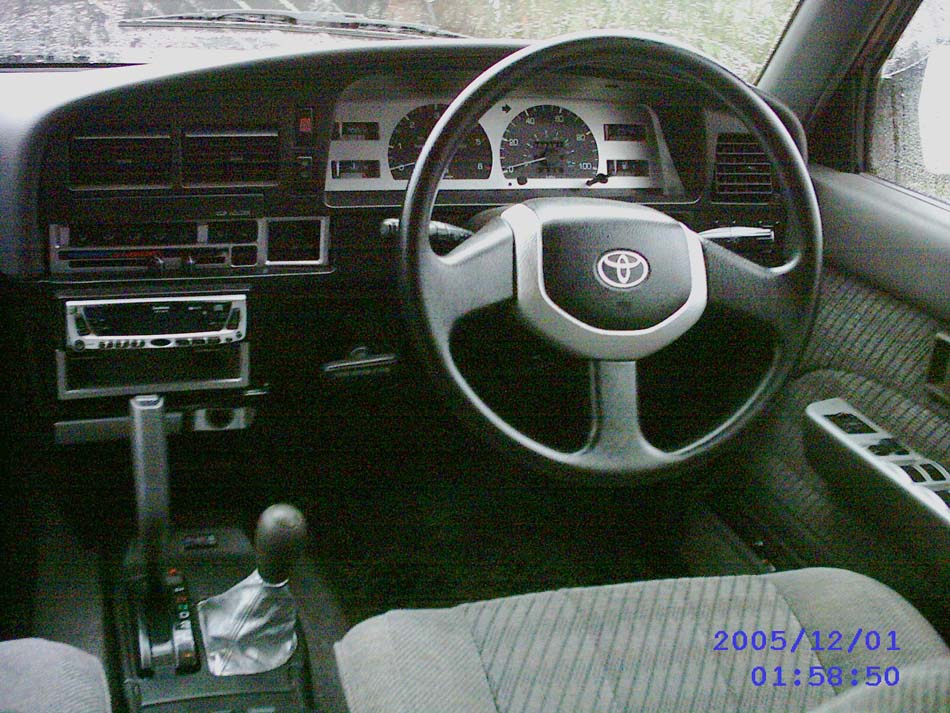

                      Here's a pic of the 'cockpit' (I'm changing the silver gear lever surround for black leather)
                      Then I'm gonna get the seats recovered in black vinyl with slate grey vinyl door panels.
                      On a mission to pimp! (tastefully of course)
                            I likes it......... do you have a lady who comes around? That looks NOthing like the inside of my skip.......
                              Vince, it appears that the silver paint is spreading. What exactly has happened to your Hi-Low gaiter?
