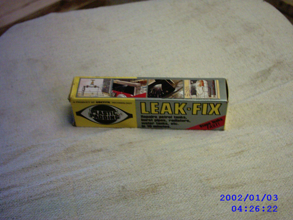

        Maybe try some of that leak fix stuff. Just make sure the area is de-greased well first tho'.
        It's normally next to the bodyfiller in motorists shops. You can get it in a mix together paste, or as a putty. It's supposed to work on radiators so It should work on your pipe.
