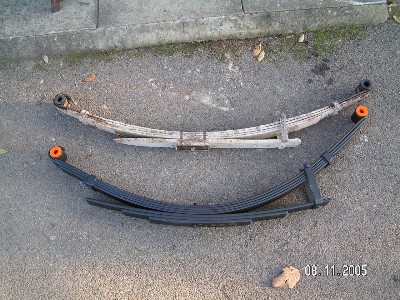

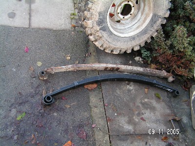

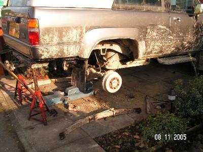

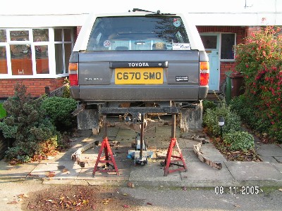

    Spent the last 2 days fitting an Explorer Procomp 3" lift kit . Yesterday I did the rear .
    The old springs were knackered and all the shackles and pins seized so there was no movement in the suspension . Dampers were not to bad but ES3000's fitted now .

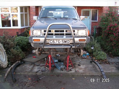

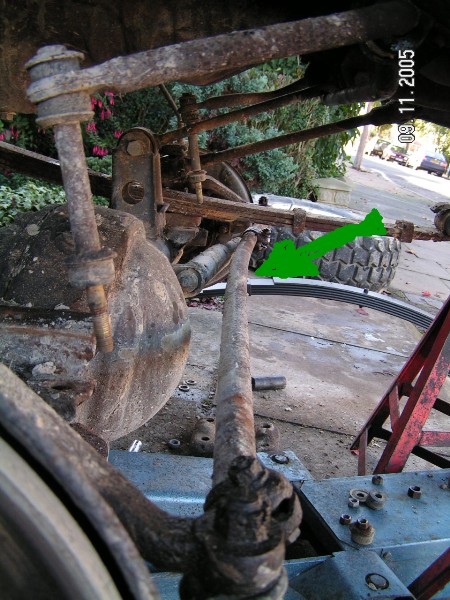

    Today I did the front . I now have no front antiroll bar as this would mean blocks and things , but I am not bothered about it as only resticts articulation . Again all pins and shackles knackered , shocks OK but replaced with ES3000 's

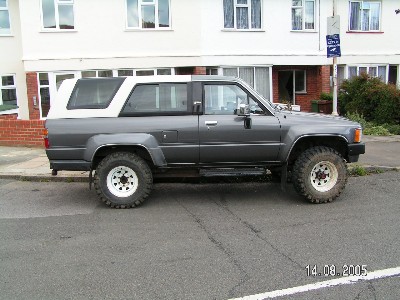

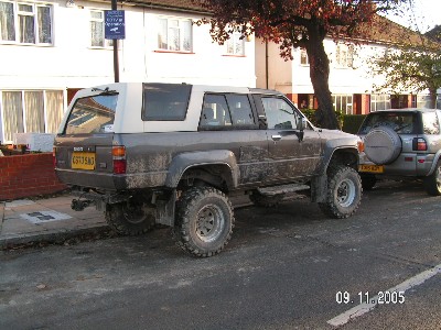

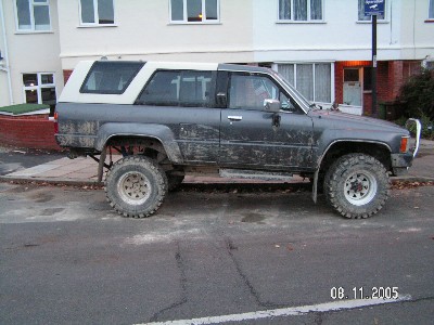

        Before and after . I got more then I thought . Old sus must have been real bad as I gained 5" on rear and 4" on front .
          Found some damage I must have done at 4x4 show . Steering link well bent . Hopfully Tim is bringing one from Tony for me tonight on his way home .

            Man that was a saggy ass before .
            That looks really good now , did you have to extend brake hoses etc ?

              Looks the mutts now... pics show a heck of a difference in the new/old springs....and yes even a muppet like me can see steering link is not as mr yota intended it. Good Job Good Pics

                steering link doesnt look too happy
                              I took it for a drive with just the rear springs fitted . Wot a laugh ! I could only see the road about a foot in front of bonnet . Got some funny looks from passers by and some kids were pointing .
