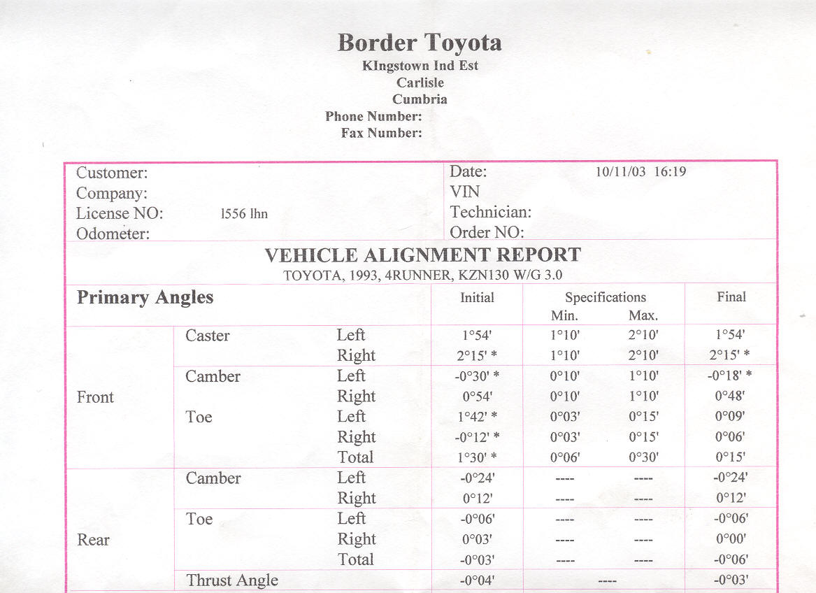

        Just print the attachment off and take it anywhere. anyone competent with the gear should be able to set it!

          Mine cost £28.00 at an independant garage. They used the 4Runner data from their laser alignment computer. It's been OK ever since.
