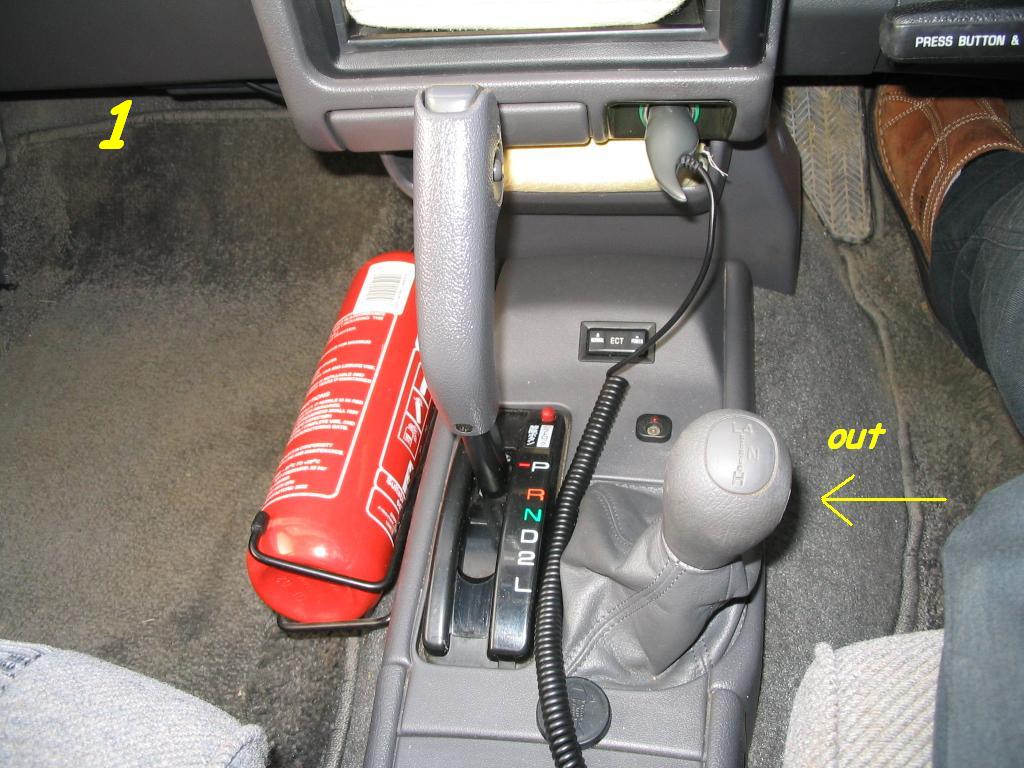

Pic 1. 2 wheel drive.

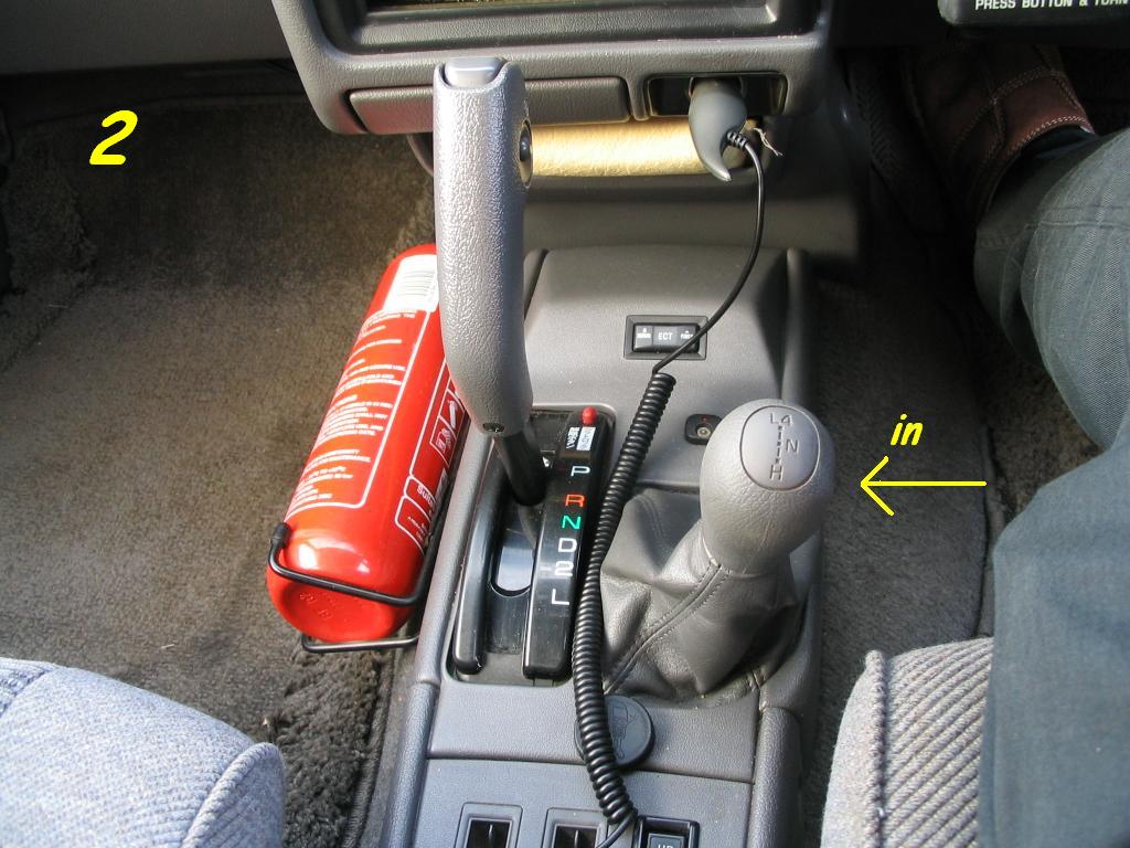

Pic 2. 4 wheel drive High ratio. Can be engaged or disengaged on the move up to 80kph. (4wd will light up on dash)

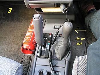

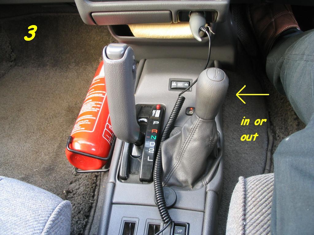

pic 3. 4 wheel drive Low ratio. transfer lever pushed forward, button in or out. must be engaged or disengaged while stationary and with gear stick in neutral. (4wd will light up on dash)
if 4wd light does not immediatly come on when engaging or go off when disengaging try driving forward or back a little way till the light goes on or off.
