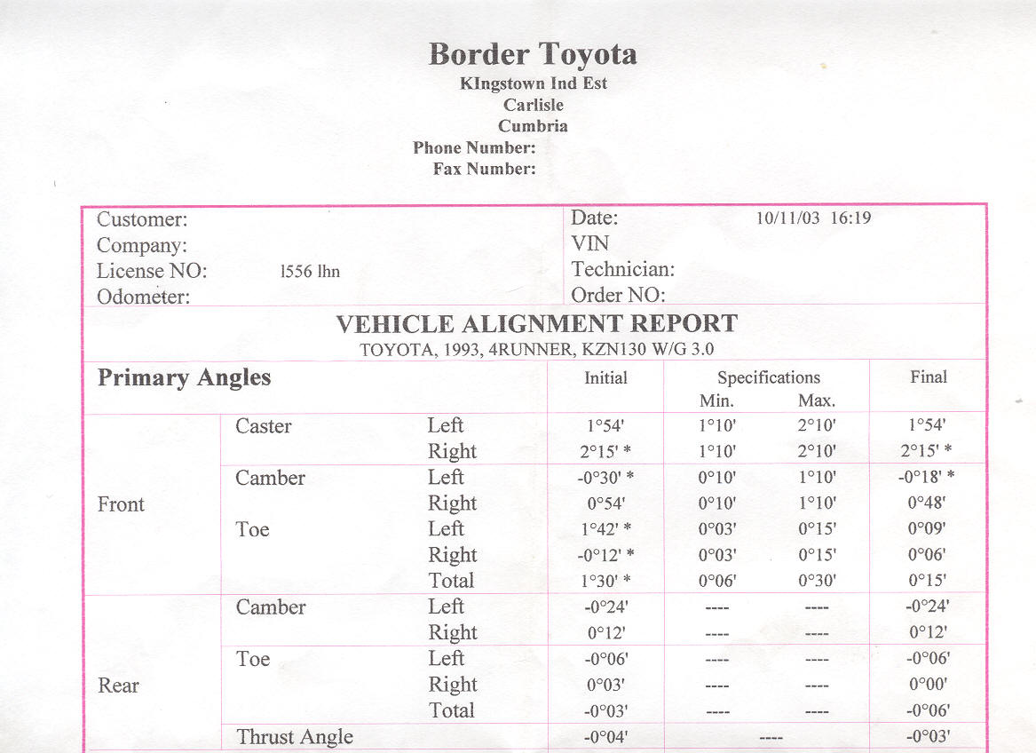

can anyone tell me the towing in and out values in degree's for my 3rd gen with standard size wheels and tyres.
replacing the tyres soon and they have worn more on the inside.
want to get the tracking sorted at the same time
