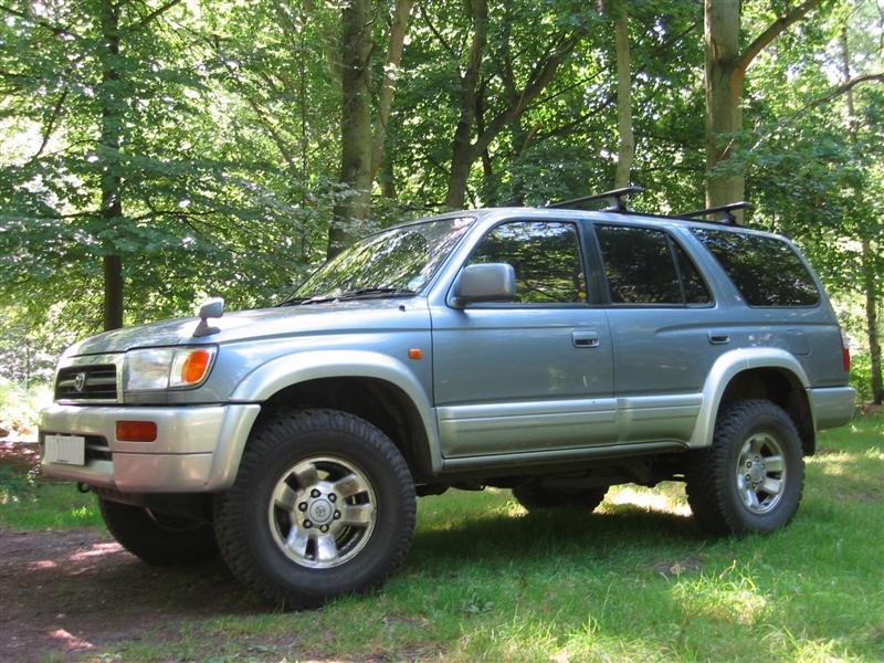

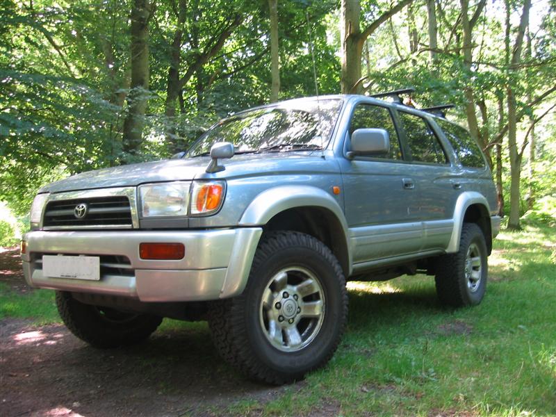

Well I finally got around to buying and fitting a 2" lift kit from Explorer so I'd thought I'd show off the results.
Went on pretty easy with the help of spring compressors and lots of determination (unbolting the rear shocks is a right old pain in the ar*e!!!!)
The only slight concern was the lateral deflection of the panhard rod....but I got a clever person to work it out and they recon it's only 1.3mm with a 50mm lift so I'm not gonna worry about it. The other thing was increasing the angle on the front CV's but it doesn't seem to bad to my untrained eye so I might make up some diff drop spacers but hold off fitting them until after the springs have settled a bit......anyway here are a couple of pics
