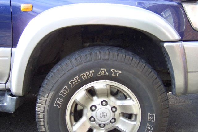

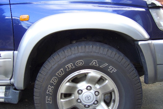

    Been taking advantage of the good weather today by doing 1 1/2" Milners body lift.
    Easy job on the 3rd Gen as the body is only held on via 8 bolts, which are all easy to get at.
    You need to remove the front bumper to get at the front 2.

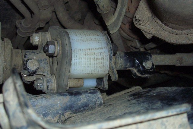

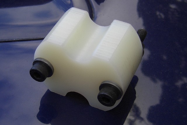

    Made a nylon steering link adapter at work and also got 2 longer M8 bolts for the link, these were the only extras needed, the Milners kit comes in at £55 + vat so is a pretty cheap lift and only takes a morning to fit.
    Had to drill new location holes on the front bumper mounts to raise it same as lift, also had to elongate the fan shoud holes to move it down slightly (1/8") as the fan was just catching at the bottom.
    Nothing very taxing and all done on the drive, well happy with the outcome.
    Pictures show - before, steering link adapter, link adapter fitted & after shot showing difference on front wheel arch.
    I have diagram for the link adapter if anyone wants it also have CNC points for machining.

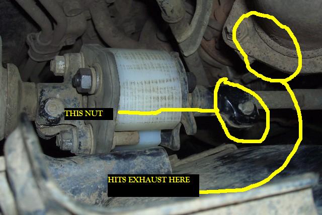

        trouble was with 2" lift the steering extension causes the nut to touch the exhaust.
        cos it's designed for a LHD motor, US never had any trouble with it!

          That is going to hurt, even after a short run...

              Just came with the 8 spacers & bolts, made the link adapter meself. Modding the front bumper brakets isn't anything hard just a case of drilling 2 holes 38mm lower.
              Not got any clearance problems with the steering bolt & exhaust though this is 1 1/2" body lift not 2" lift.
