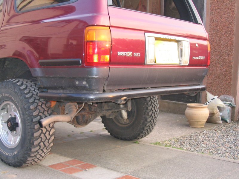

    Had this dent in rear bumper for a while.
    http://www.yotasurf.co.uk/forums/att...id=12358&stc=1
    Got a day off tomorrow, so might have a go.
    Now the questions.
    1) Bumper easy to remove or not? had a little look underneath, doesn't seem to be too many bolts in hard to reach places.
    2) Is the bumper in sections?..cos that's what it looks like, can the side portion be taken off with out too much hassle?
    Would appreciate any comments/ suggestions (Nice ones now!)

    Sorry, but there's a hint of silliness here.... No pic!!!

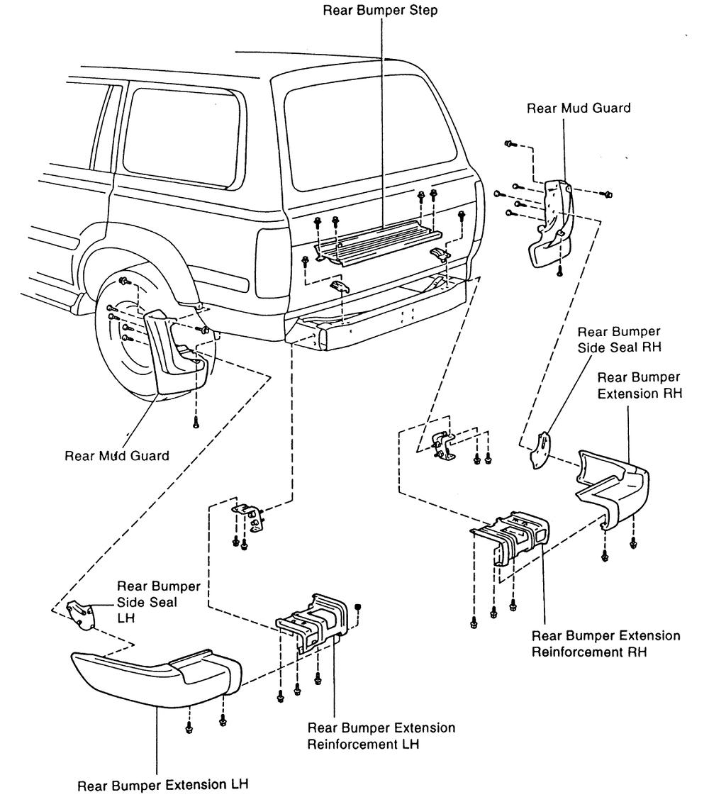

      Yea side sections need to come off first, bolts are fairly straight forward.
      only real thing i found is when taking the centre section off take it off with the brackets on. ie unbolt the brackets from the body not the bumper. hope that makes sense.
      not as complex as it looks on the pics. the mud guards stay on the side bits and some of the brackets stay attached to the car.

          Thanks for the diagram Greebo, I'll add it to the many I have collected on the Surf over the months.
