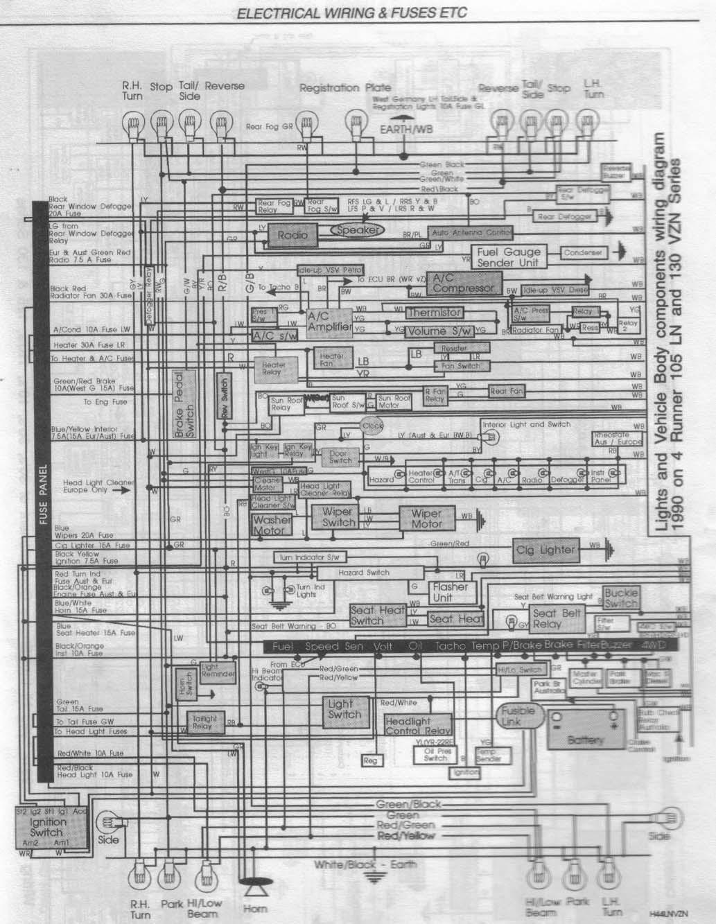

    Hi. I have just bought a 1992 SSRX 2.4 diesel. The workshop manual says that there is wiring in the loom for rear fog lights, but it covers several years/models and is not that clear.
    Does anyone know where/if the end will be in with the rear lights, or tucked up somewhere out of view, and whereabouts in the dash will the wire be located, so I know where I can put the switch. Also, what colour wire am I looking for?

    The attachment is a wiring diagram for a 1990-on 4Runner and it shows the wiring for a rear foglight with the colours and also a rear foglight relay. As the foglights are not supossed to be on without the taillights then that must be the function of the relay. Not sure where the wiring may be hidden but hope this helps. The switch for the rear foglights on my Surf, (which were fitted after import and before I bought the Surf) is on the far r/h of the dash where the suspension hard/soft switch is located so that may be where the switch wire is located by the factory. Don't know what the Starbo Mode Switch is - it may have been for some after market stuff the original owner had fitted.
