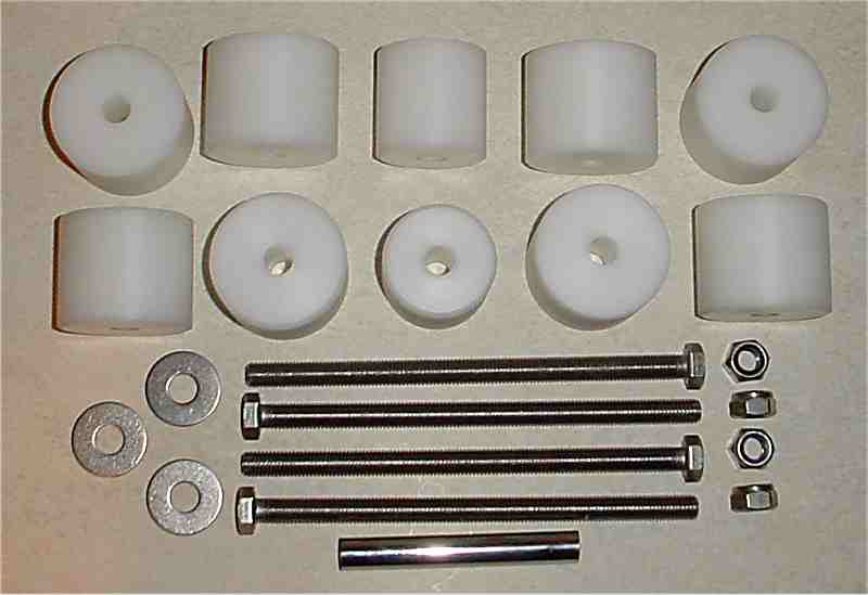

Trouble is the blocks & brackets (easy to get made in UK) and long bolts required (easy to buy) weigh a tonne making shipping costs a bit silly (more than the actual components by UPS!!).
So what we probably ought to do between us is get a batch made here in the UK. The attached picture is my first attempt at a 2" lift block kit (I'm being quoted for a larger batch of 100 blocks on Monday). The material cost for 60mm dia Delrin (Acetal) rod is around £25 - £30/m (+machining). The 200mm long M12 stainless bolts are around £2 each (or Zinc plated would be cheaper)

Nev - Tony's going to be making these as well as fitting, check out your PM's under the other login...
