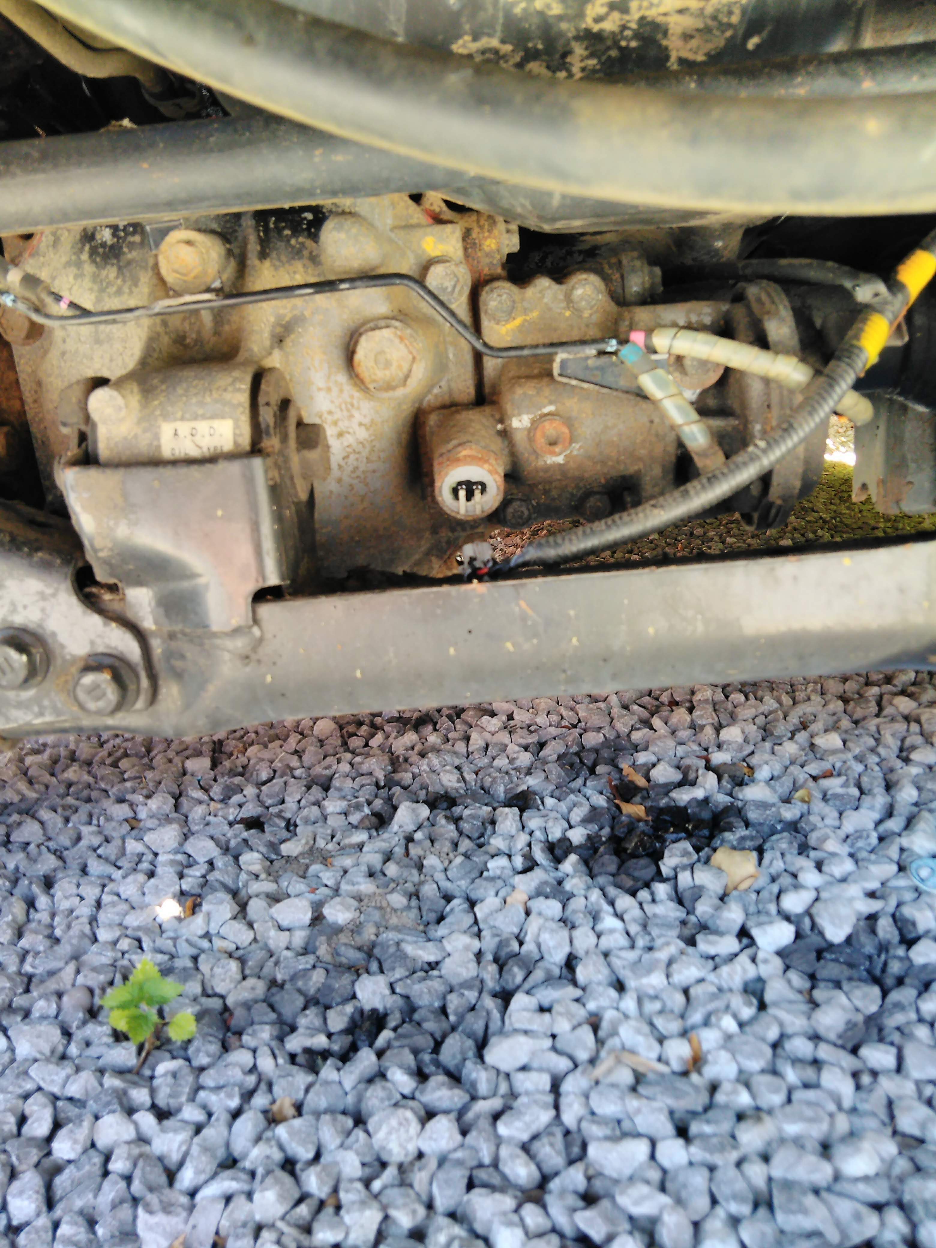

    Evening all
    Put a belt on my A/C pump which never had one on since owned it tensioner adjuster was knackered.
    Sorted it all but dropped a nut in the process and upon looking noticed a grey broken plug on front of the front diff but what is it for?
    ​​​​​​I don't appear to have any diff lock switched in cab or out.
    Cheers Ben
    It's a roller switch to activate the green 4WD light on the dash.
      Dur why didn't I think of that.
      Thank you bushwhacker, it explains why it isn't working I just assumed yet another bulb had gone in the dash. Feel a right Rodney.
