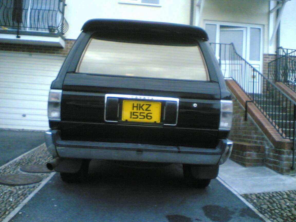

    I was just checking out the pics of Codlords truck (nice truck by the way and in the best colour!) and I noticed that the rear lights are different to mine, having the reversing lights in the clusters. Mine has the spare underneath, which means I have reverse lights in the centre of the tailgate.
    Is it possible to swop the rear light clusters from a Surf with the spare on the back to ones without and then tint the clear cluster reverse lights red and fit fog lights in them instead? Would this work, has it been done before?

                    Finally got all the parts and the time to do this - just finished.... and happy to say it worked a treat!
                    I'll try and explain what I have done because it isn't very clear from the above discussion about whether it was possible or not.
                    Basically, my truck has the spare underneath and the reversing lights in the middle of the tailgate. Both rear clusters had just a combined light/brake light and indicator and appertures just for the required 2 bulbs.
                    What I have done is swopped my original clusters with the clusters from a truck with the spare wheel holder on the back. These have reversing lights in them so appertures for 3 bulbs. So my truck now looks like it has 4 reversing lights, but I have to say it doesn't look strange.
                    I bought some high power red LED bulbs that are a direct replacement for standard fog lights and wired them into the reversing lights in the new clusters. Thus I now have high power fog lights on each side of the truck and my original reversing lights still in the tailgate.
                    Total job time took about 20 minutes once I'd got the additional wiring bits from the scrappy and the job looks really neat and tidy.
