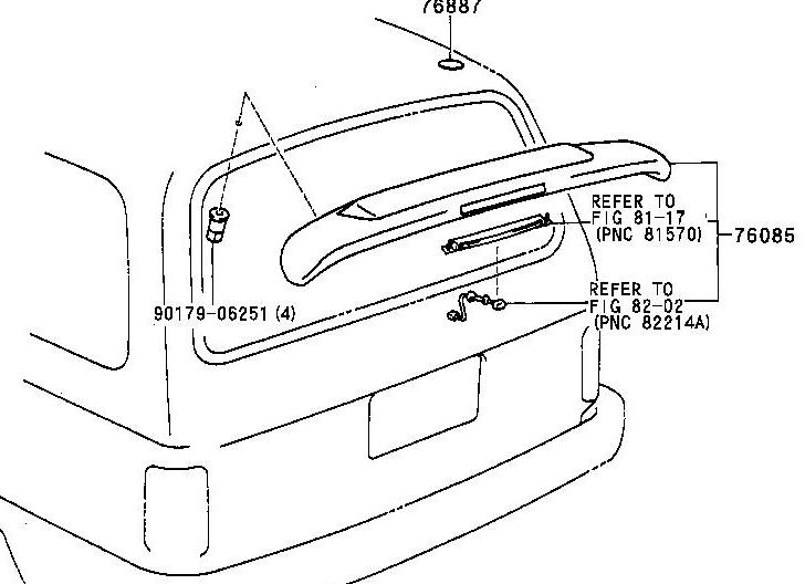

    Anyone know how the standard (2nd gen) rear spoilers are attached to the bodywork?
    Also anyone know where to get them? I know Roughtrax do a spoiler but I don't like the look of it - its not the same as the standard Toyota one.
    No longer a Surf owner.
    There are studs coming from the spoiler into the area of the wiper motor. Thses are attached using extended nuts. If i remember i'll take some pics
      So actually through the metal bodywork then?
      I thought it must be as I couldn't see anywhere else for it to be attached.

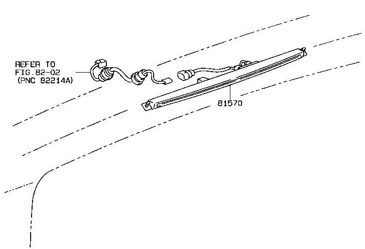

        These may help
        These are using the details for my vehicle, a 2nd Gen LN130W
