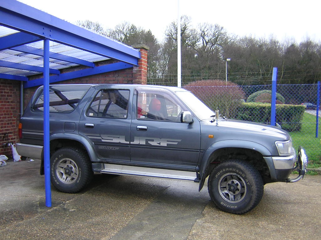

In order to replace the damged rear shock I've ftted a 2" lift with nitrogen shocks.

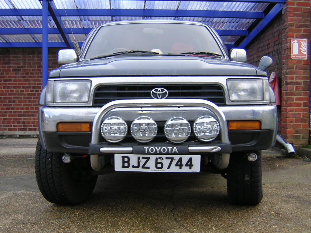

The four spots have been fitted on the 'A' bar with the fogs under the valance, each pair of lights has it's own relay, with 2 additional relays allowing you to switch on the fogs, the dip adjusted spots (the inner two), or with the main beam all of them.
The number plate that got smashed at Salisbury has been replaced, but this one has two sheets of steel behind it, we'll see how it fairs next month.

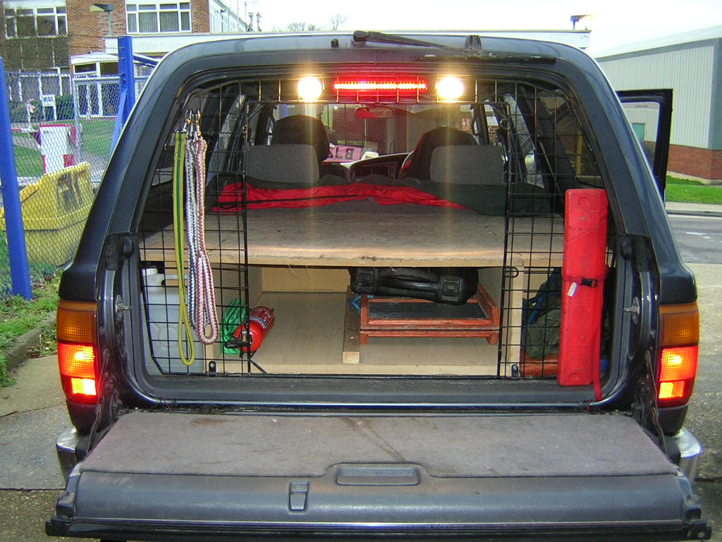

The rear has a high level brake light fitted, with two working (reversing) lights feed from a seperate fuse box I fitted in the rear, with it's own clean feed.
The back also has a custom built storage system.
What isn't show is I also fitted a 4 sensor revering aid, so hopefully I won't reverse into any structures that have been standing since the 1950's (ie. my own carport).
Pictures attached, I think when the tyres get low on tread I might need 32" as the 31"s now look a bit small in the arches.
) how do you get one set to be used aas dipped as well as full beam ?
what are those little things on the underside of the front bumper
