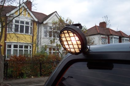

          It's not road legal but what about a rear facing roof mounted spot. Powered via a relay and switch. You could switch it on when off road or on private land. There should be no need to use it on the road because we can all parallel park.
          like this... ?
          Tim
            I mounted a pair of small spotlights (meant to fit neatly on front spoiler of cars) to inside of truck boot roof by back window. Fixed relay and wires in panel at the top out of the way. All it takes is to lower rear window and switch on the lights and perfect vision for reversing / hitching trailer, however after 20 minutes heat from lights can slightly melt rear plastic panel above lights, but if you are reversing for that long then truck is facing the wrong way! so not really a problem.
