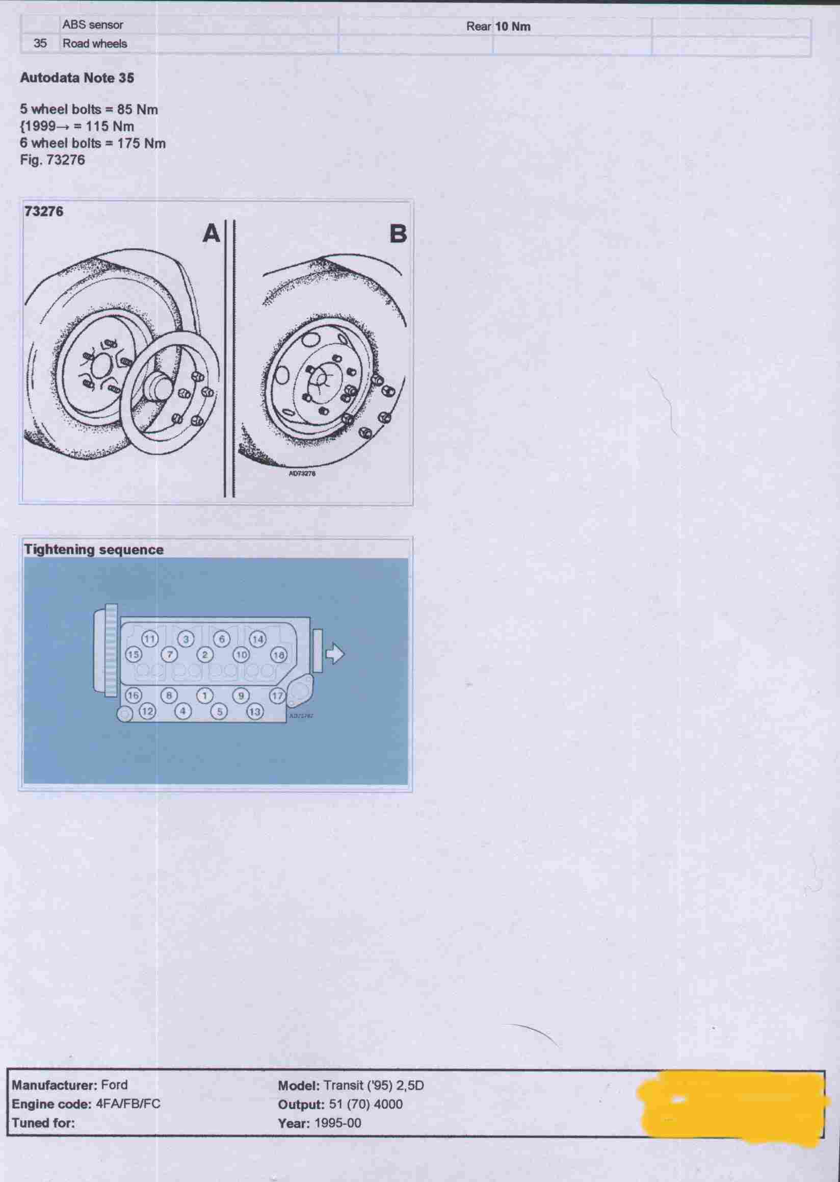

Anyone got a Ford Transit workshop manual handy?
Its a R reg (97?) 2.5 desiel, need the head tightnening sequence and torques and valve clearance's.
Cheers.
(before 7:00am tomorrow please......)
