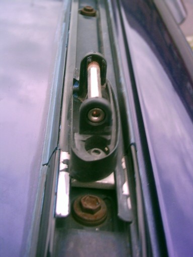

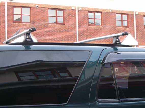

    If your Surf has roof rails this worked for my 1998 model:-
    Found the thule part numbers and the pdf file from thule themselves:-
    http://www.thule.com/PabloImages/Document/68/1668.pdf

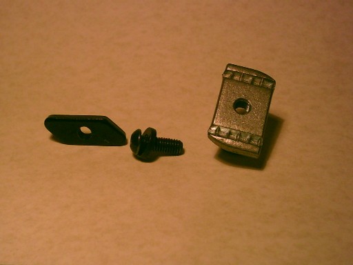

    Page 2 ,diagram 2, the diamond shapped channel nuts will not fit securely therefor:-
    To lock the end pieces into the roof rails I went to a local stockist of 'UNISTRUT' (found via a search on line) and bought - 8 X 6mm tapped channel nuts for the 1000 series track and they fit the roof rails perfectly and only cost aprox 20p each.
    I posted this earlier in the year. Mine have been on now for almost 20k miles, damn near constantly loaded with between 2 and 4 sets of ladders without any problems what so ever.

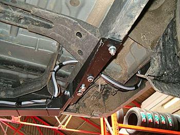

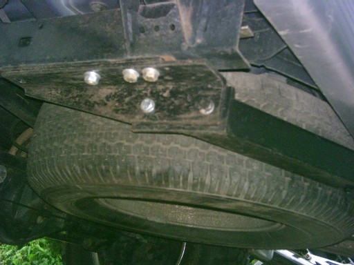

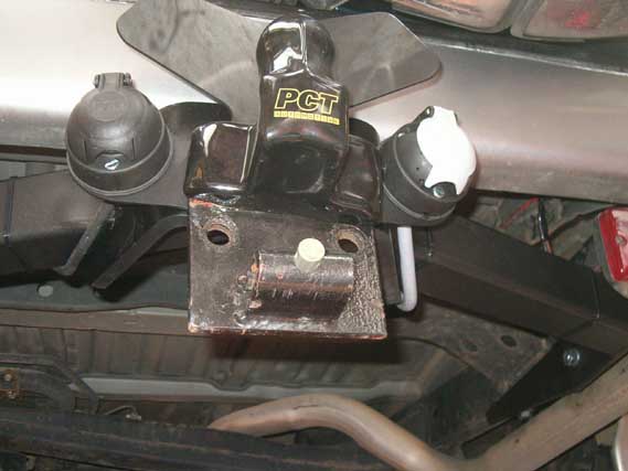

    Tow bar now fit on my Surf from Towequipe (http://www.towequipe.co.uk/) and very easy to do, it came with all the fitting and instuctions which easy to follow. Costs aprox £110 with stainless bumper protector and twin electrics.

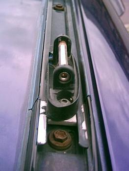

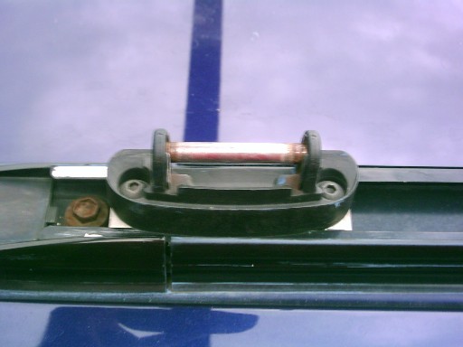

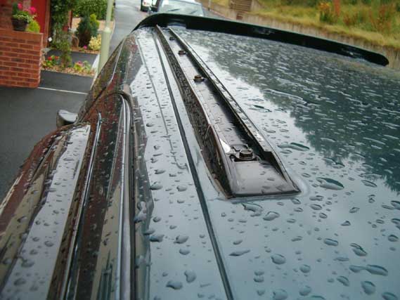

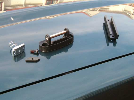

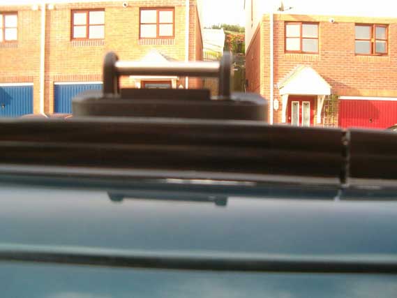

    As Ciaran requested here are some pictures :-
    The centre one shows the supplied diamond fixing, bolt and the new 'Unistrut type channel nut

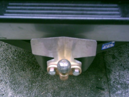

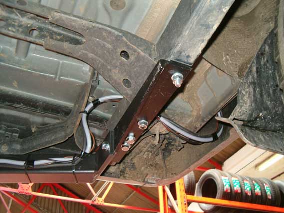

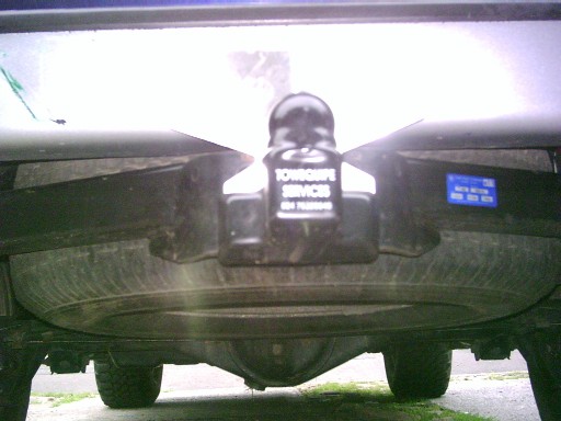

      And the Towequipe tow bracket (I should have photographed this befor going on the moor romp whilst it was still nice and shiney black).
      As I only have one of those 2' deep trailers with no lights on, I have not bothered to fit the electrics yet. Not much point when even the new fog light only lasted 20 mins at the last Romp
      Fish

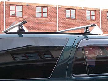

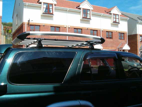

          Thule Roof rack, thanks to Fish

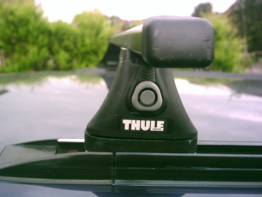

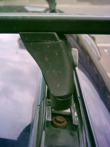

          Got It, a Thule roof rack on the Surfs factory fitted T-racks. Thanks Fish
          Like he said, you need UNISTRUT M6 channel spring nuts to fit the feet. Took me only 2 weeks to find a stockist in this area, but once I had them, the were like gold.
          Fitted the roof rack, earlier this evening, piece of cake.
          Here's my parts list, I ordered it from rbs, www.roofbox.co.uk ; www.rbc-wholesale.co.uk ; www.van-racks.co.uk
          TU4700 Thule Rapid system tracker feet (4) no.4700 £45.06
          TU4715 Thule Rapid system tracker adapter kit no.4715 £25.49
          TU861 Thule Rapid System 120cm aerobars no.861 £38.30
          UNISTRUT M6 channel nuts, 8 in total £1.68
          I got myself also the One-key system, TU588 Thule same key locks £8.51
          and the TU821 Thule Xpedition carrier basket (99cm wide x 158cm) £195.70
          photos to follow, have to crop them first, they are a bit too large
            and the Towbar...
            Towbar is a PCT one with twin electrics, 12n-12S audible relay kit and bumper protector.
            Had it fitted by one of those mobile fitters in the area, total cost was £250.
            Same as for the Landcruiser Colorado, part no. TTY4001 £146, bumper protector for double sockets part no. ZM1163 £8.93
            photos will follow.....
            www.pct-automotive.co.uk
            Unlike some others (like the cheaper ones, ref Ebay, PCT has Type Approval 94/20/EC and is almost similar to the Witter Towbar range. So I have been told!
              Roof Rack photos
                Tow Bar photos
                  Thule Carrier Basket
                      The centre one shows the supplied diamond fixing, bolt and the new 'Unistrut type channel nut[/QUOTE]
