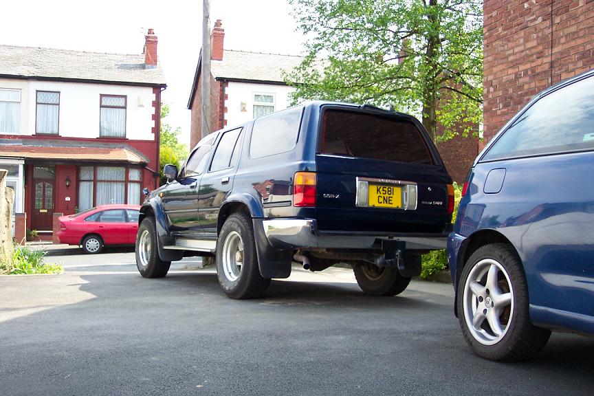

                Thanks for the info. Rear number plate carrier huh?
                How is this attached to the tailgate? Would it be feasable to get one off a scrap surf instead of having to change the whole tailgate?
                [SIZE=2][COLOR=White]You can't have everything. Where would you put it?[/COLOR][/SIZE]
                  you could by the full tailgate off HILUX he has a couple the reg plate look like this
