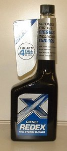

If the truck is running OK but just smokey, then all you need to do is buy some Redex injector cleaner and add it to the fuel tank, or fill the filter with it when it gets re-newed.

About to do filter changes. Is filling new fuel filter full of Redex before fitting the best way of cleaning (preventative maintenance). Or putting in tank? Would have thought filling the filter would be like wiping it's arse with sandpaper - but your advice is my bible!

Yes!Originally posted by squipper View PostVince,
