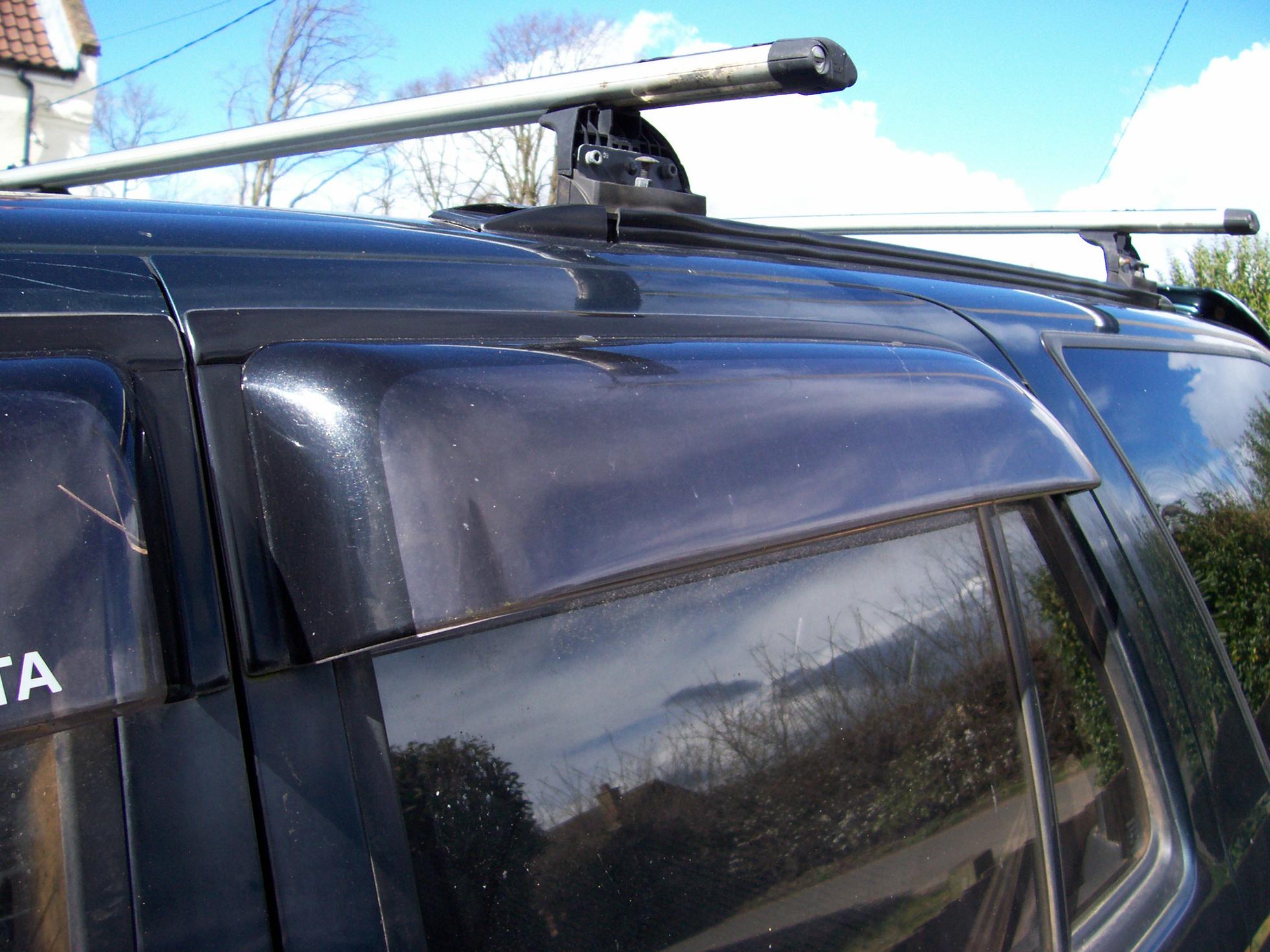

      Thank you mate, top tip will get the overalls out over the weekend.Also looking for nsr wind deflector?.
        Should have that, will check condition for you.

          Pic of nsr wind deflector. Email me rickandtam@btinternet.com if you still require it.
            Thank you v much for replying.Have sent e-mail.
