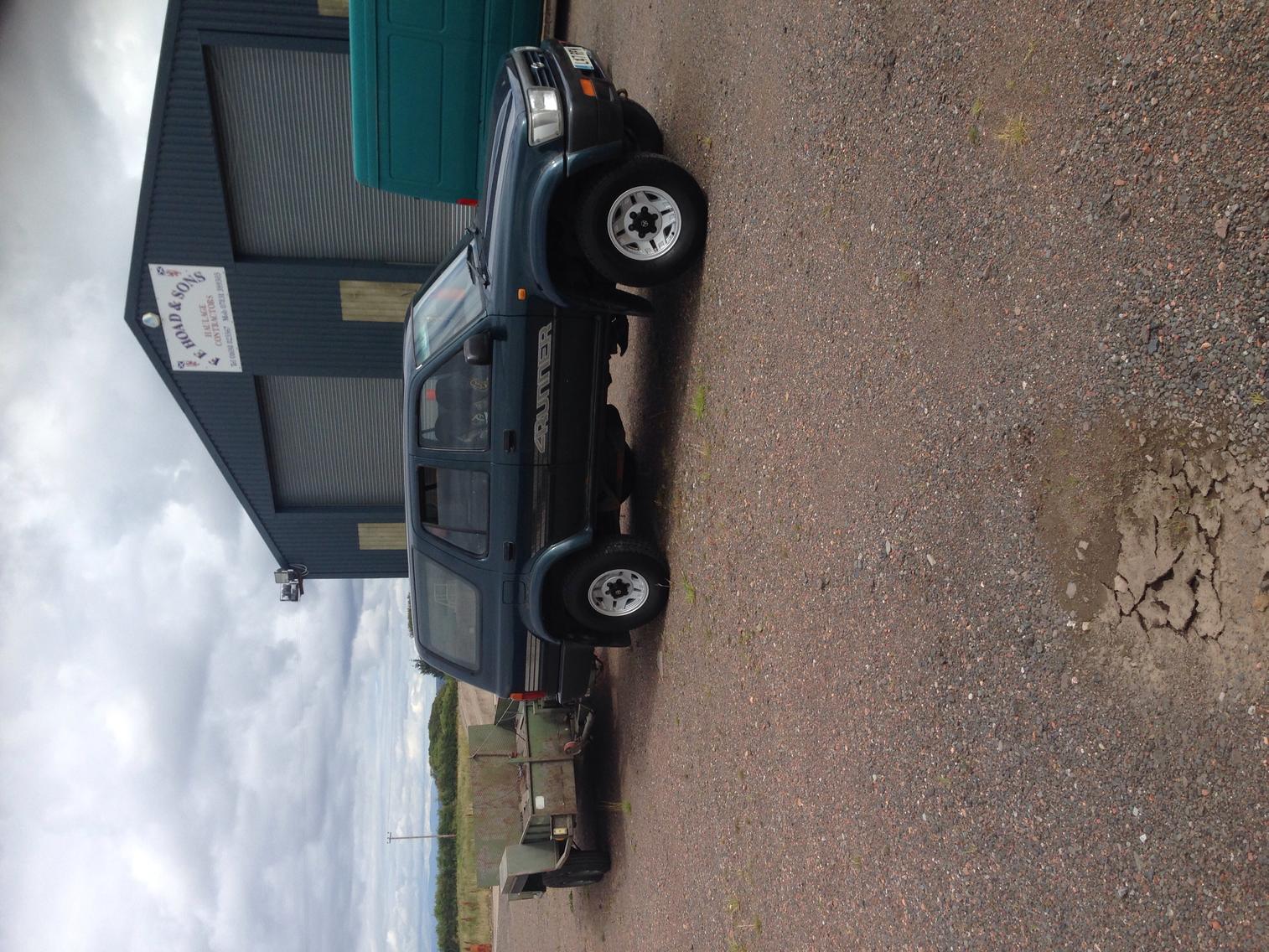

        Will post a picture later of ones I've done!
        Sorry about sideways picture, not sure why they upload like that!
