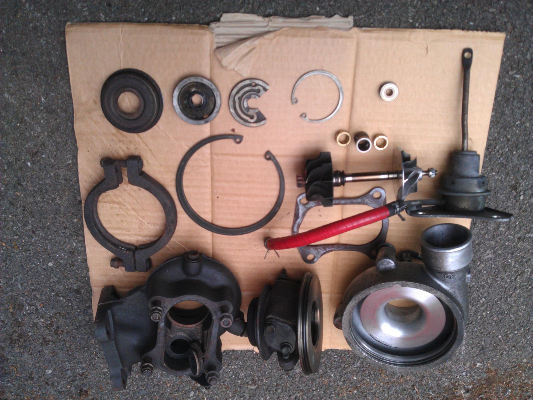

        The attachment wil come in handy, thank you.
          Getting it apart is dead easy, FYI: the impeller nut is left hand thread.
          Oh nearly forgot, if you do strip it getting the alloy and cast iron housings apart you'll need a vice to hold it and you can't knock the cast iron part round it's mount to loosen it, there are some role pins locating it.
          I'll try and find the diagram I used.

                  The nut in a CT20 needs either a special tool or a pair of mole grips (it's not very tight).
