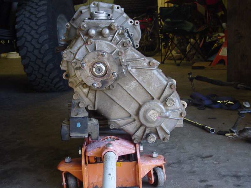

    has anyone got a VF1A transfer case - its the chain drive 5 bolt rear case unit with a top shift. its a manual case without all the surf electric shift gubbins.
    heres a pic to identify it if it helps

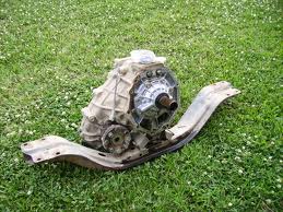

    Gary , can you post a pic of the other side of the transfer case ie gearbox mounting side . I may have one in the cellar.
      this is the best i could find on the int - should be clear enough
      if it has a 5 bolt casing on the rear output it is a chain drive manual case. obviously without the surf type electrics.
      if its a gear driven case it will have 7 bolts.
