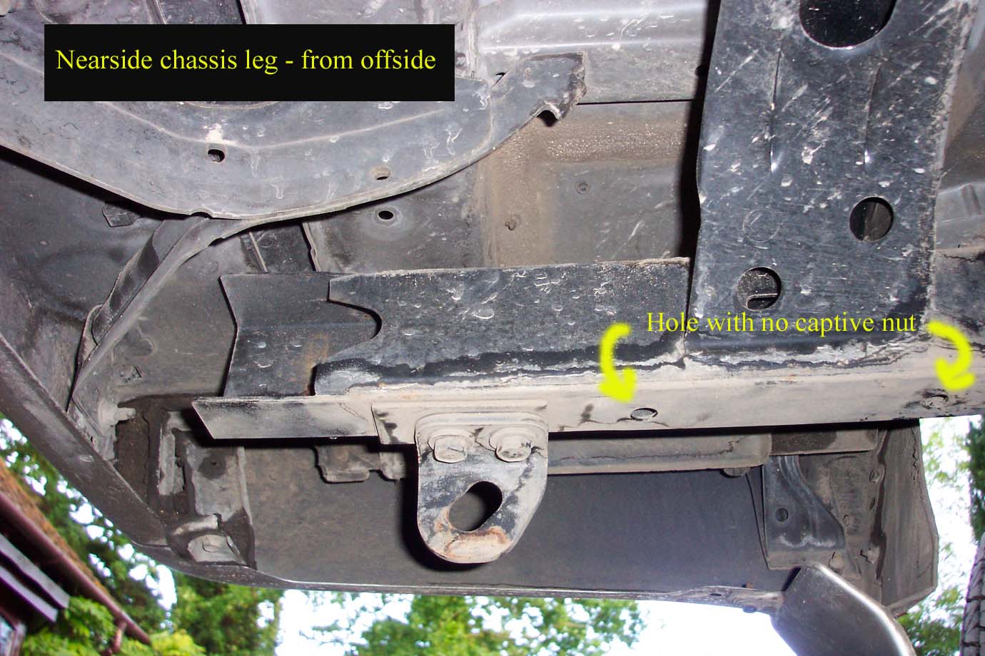

I had a problem in that the instructions refer to a captive nut on the chassis - all I had was a hole. I phoned Towequipe at 4.45pm on a Saturday afternoon and got through to their helpline immediately. The guy said that the bar was originally designed for the Landcruiser and that they had experienced a few niggles with the Surfs sometimes being different. He asked me to e-mail him a pic of the problem. On Monday he phoned with a solution and I received the modification today.

If you decide to order, just check under your Surf and see if the holes in the chassis have captive nuts or not. The two nearest the back should be captives as they have the towing eye mounted on the nearside. The next one forward is a plain hole ( they provide a bolt on a "stalk" for this one). If the next one is also plain, tell Towequipe (ask to speak to Roland) and they will send you the same mod as they provided for me - a nut on a "stalk" and the coarse threaded bolt to go with it.
I'll attach the photo that I took which might help.
