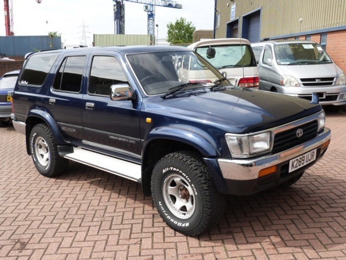

How much do you want to spend and what sort of condition are they in right now?
A tube of autosol and a rag will do wonders if you are on a budget or a full powedercoat refurb if pockets are a little deeper. I would always be wary of just sticking a coat of 'alloy paint' on as its not a longterm fix.
you start with paint stripper.
then acid bath and shot blast.then wet and dry,start at 180,then 400,600,800ans finish with 1200.best done on a lathe if possible
drill out plastic bungs,and tap M8 for shiny s/steel cap heads
then,Autosol is your friend,take time,small circles,and the results are worth while
centers are from roughtrax,£6 each
I have been given a budget by the missus as i have other things to get ie: Suspension lift and to take the side steps off as well as painting the underside.
I have a budget of £2k from the missus, thats for lift kit, new tyres and wheel refurb. The alloys are really bad, so i would like them back to how they should be ie; "look at me". what company is the one in gloustershire and does it have a website? cheers Daz
