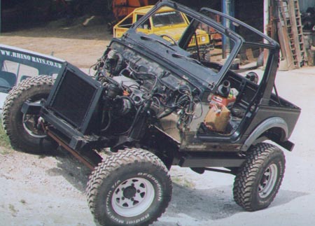

    Well, sort of. Just going to enclose the engine, having bashed in the bulkhead where the back end of the wheel arch used to be. I have had a measure up and I should be able to get 35" tyres on as there is nothing to foul now!!!!!!

      That's not my Zook in the pic'. I nicked the pic from Rhino Rays site just as an example. Of course mine has the back off as well.
            You might fit the 35's on Phil , but the 997cc elastic band will need to be upgraded to a minimum 1300cc Zook or 1600cc Vitarara lump . Prop and drive shafts will snap if not Samuri units . I learned that when I bought a set of 31's for our Zook , they now live on Jottos wheels .
